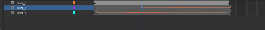

    kglad
    Apr 12, 2022 3:16 PM UTC
    there's some problem with your understanding of layers.  i'm not sure what that problem is, but again, you just need a (ie, one) layer for each sound (instance).
    i'm not sure this will help you (again, because i don't comprehend your misunderstanding), but:
    A. verbal info
    1. streaming sounds (in different layers) can overlap without causing a problem for either sound
    2. streaming sounds (in different layers) can play simultaneously without causing a problem for either sound
    B. pictorial info of same sound used to play two instances that overlap and stream
