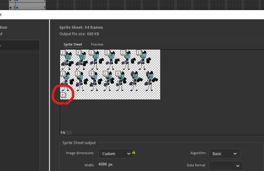

Sprite Sheet not fitting my character!! (HELP NEEDED)
Hello. I am very new to Animate and I don't know how to solve this, whenever I export my animation as a sprite sheet, one frame is cut out of the space (picture for more info). FYI, the animation is 69 frames long, there are 5 symbols, 1 has 5 frames, and the others have 2. I am exporting those symbols only. yet it still does this PLEASE HELP!!

@BOOTO This is because the output frames is overflowing from the designated sprite sheet size (4096x2048 in your case).
If you really want to limit all the frames to your dimension, try reducing the size of the symbols & export again.

Thank you so much, The problem was that I had a rectangle around my character Because coding stuff and it was too big to fit. Again, thanks
