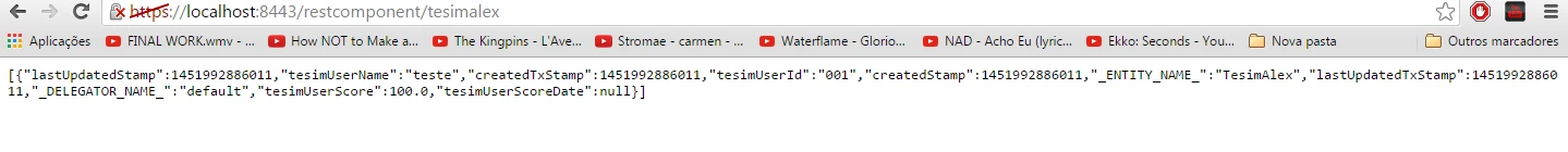

My REST service is a simple GET, if I type the url in the browser it shows me the JSON returned.

I really don't know about that link but as I see  it's a security problem, because it doesn't open in the browser also for some security reason! as I see that you've disabled the secure browsing that's why it's working in your browser but not in flash. Anyway try to upload the file to the server because the security conditions well be different then check if it'll work there, use a text field to show the data.
January 6, 2016
Add the file extension after the file name and make sure that you're allowed to access that fie hosted on the server
https://localhost:8443/restcomponent/tesimalex.???
January 6, 2016
Its not a file... Its a REST GET method... If I type that url in the browser it shows me the json returned.
I tried with this: http://ip.jsontest.com/ and it works, can it be from using https instead of http?
