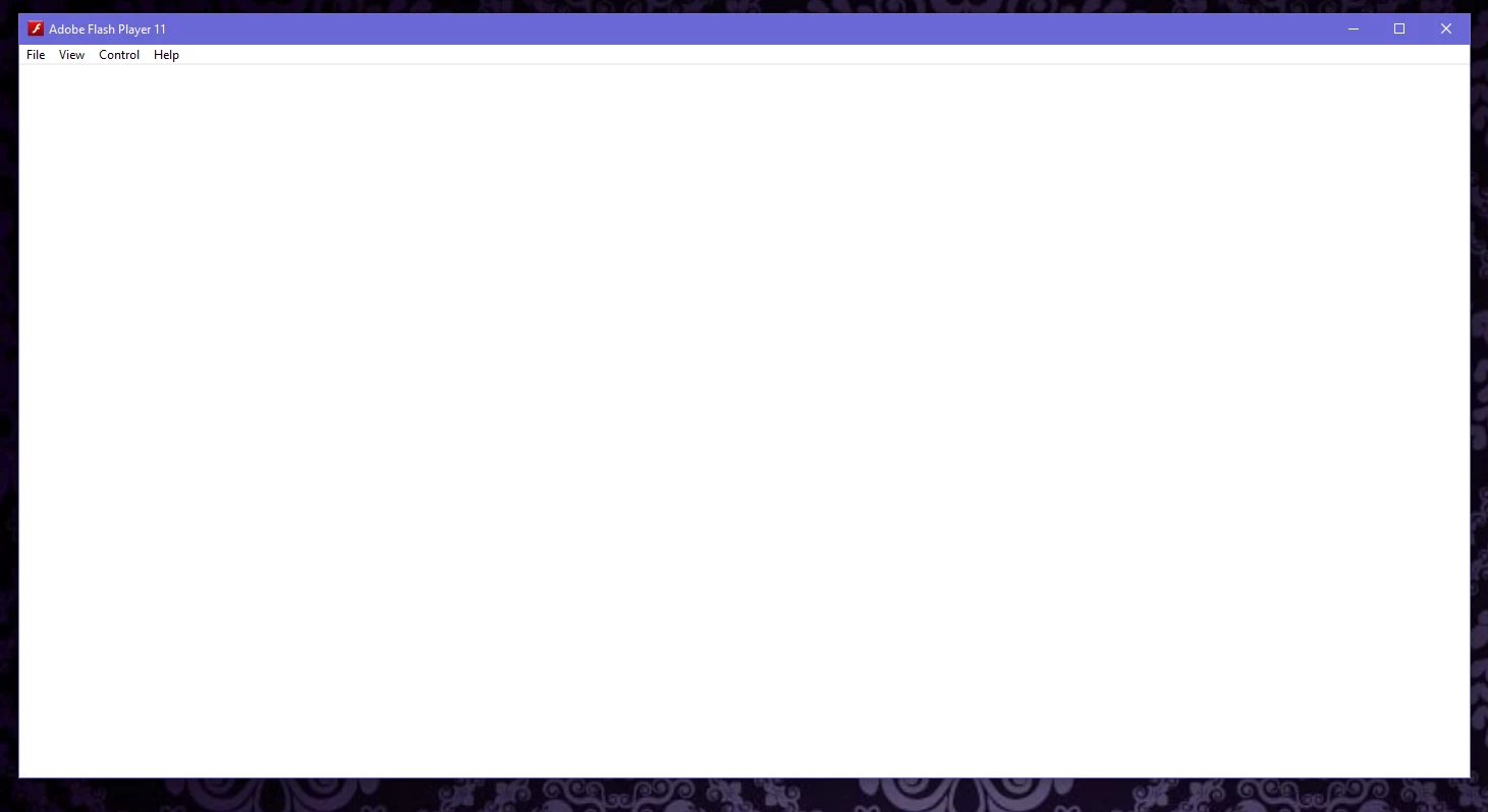

I look back at the swf exported through Animate within my downloaded files,
but I then happen to notice that I get a white screen everytime I play the SWF,
nothing else plays.

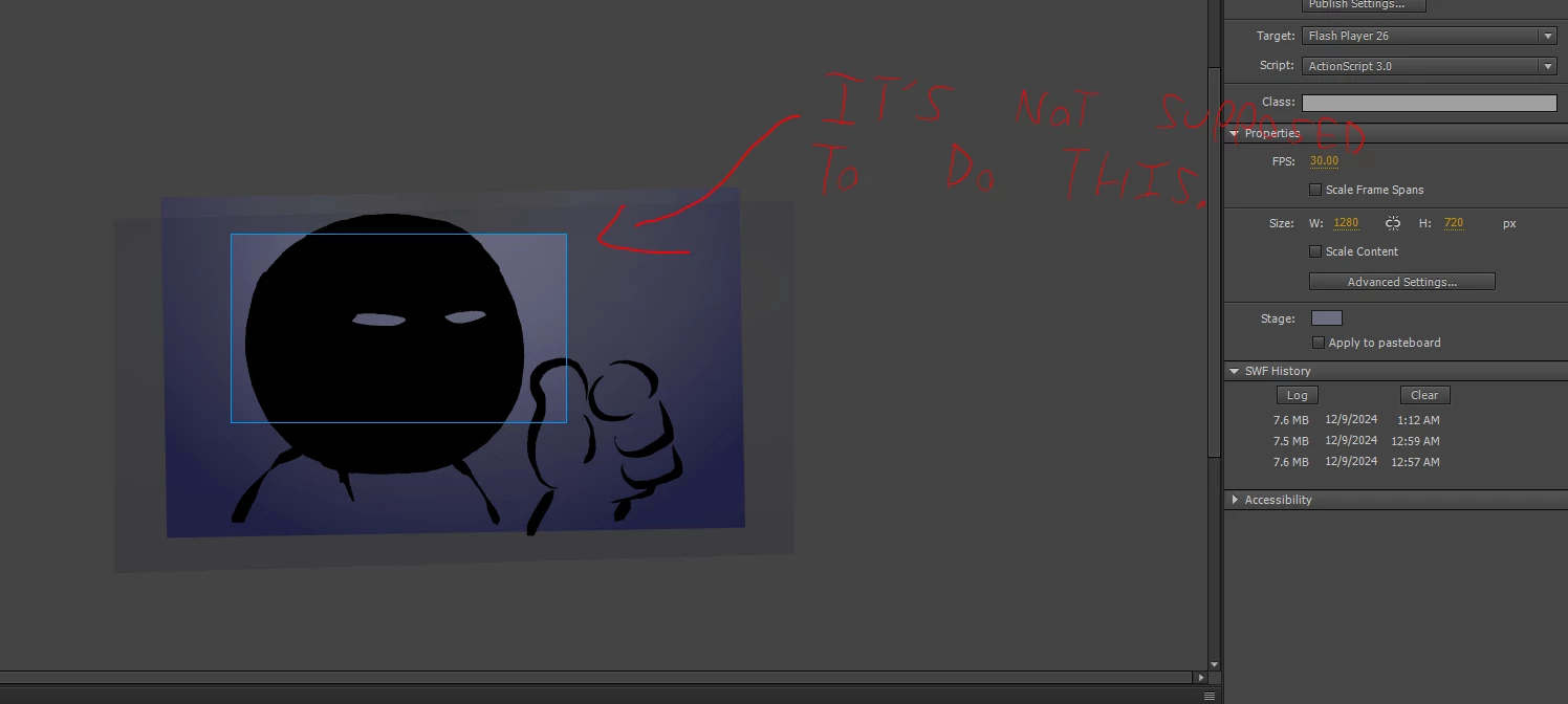

Everytime I try to change a thing or two about this issue lurking on my software
(such as removing a section of the fla, removing a big effect intro it had at the beginning, or even just decreasing the screen ratio 1920x1080 into 1280x720 WHICH also made it worse and had gotten bugs from it), it just keeps exiting out of the software as I try to export it in different ways.

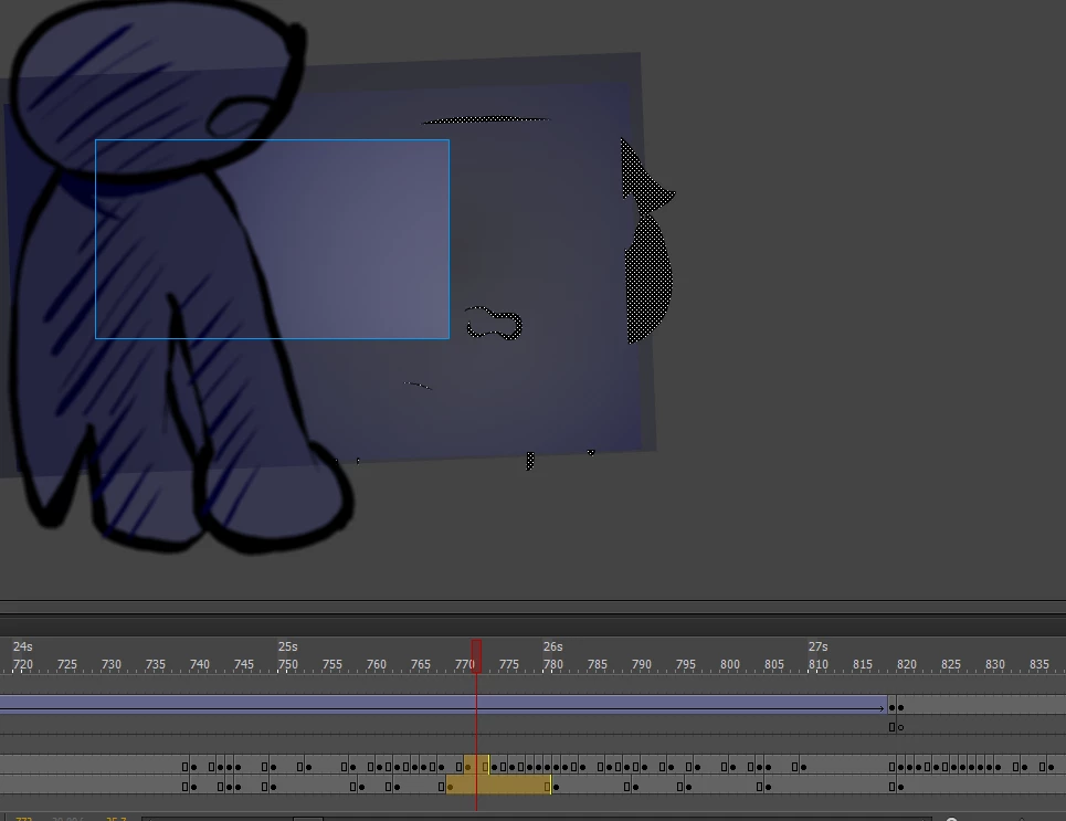

(but they only gradually get worse and more buggy/ruined if I change the screen size of the fla just for it to export normally, and it lags as it tries to change it too.
I provided a demonstration as the secondary images/additional video example under this paragraph.)

I kinda did what you did in a way, I wrote it down on a document as I went through layer by layer, and apparently, "Layer 8" seemed to be causing the software to close out, and the SWF to crash, Layer 8 only had gradient shape-tweens in it.
I am a little confused by why that would be the only problem despite the fact there are Movie-Clip symbols (for VFX) overlaying the rest of the other layers, I would assume those effects would have been using up most of the rendering process for the SWF/Software, and generally causing the issue, but no, it was just the shape-tweens.
Is this common? Would this be happening due to RAM issues? Please let me know, if possible.
