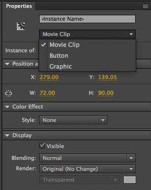

just.emma
November 13, 2016
In the properties panel, change the behavior from "movie clip" to "graphic".

Yeah, I did that. I have made another symbol and animated within it, and its fine, its just the paw for some reason... Maybe I messed with it too much :s
