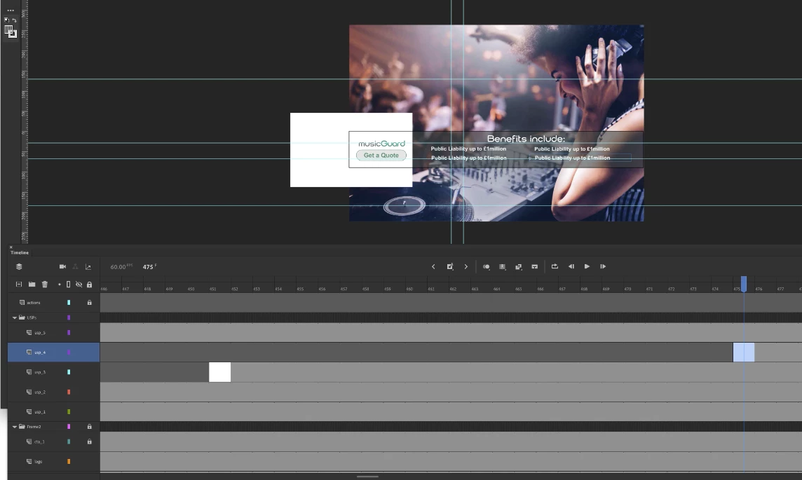

Hi all,
I'm looking for some help as a novice user of Adobe Animate.
I inherited some HTML5 banner designs of various different sizes from an agency, and my job is to delve in and change the image... job done. The problem is they now want me to add some detail to certain ones.
I completed the suite of banner and published them and the html file that was exported is perfect, however since I replicated a file to do a different version (different file name etc) – and without even touching/opening all the others – when I go in to the fla files one particular part of the animation has just reverted to the same few words over and over, which I have no idea on how to fix?
What seems stranger again is that if I publish those files it actually shows me the correct wording (a tick list of 3 benefits) but in the animate doc the 3 lines just repeat the 'benefits include' line?
How could this have happened? All I did was take one of the files, duplicate it and rename and then tweaked that design?
I'm stuck as they require the edits asap, but it's difficult to edit correctly when I see something different when previewing as to what it publishes as.
Any help would be appreciated, and if anyone needs further details I will try to provide them.

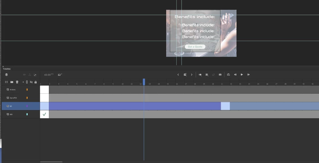

Screenshot 1 shows how its repeating the same text over the 3 lines. Screenshot 2 shows me within that usp2 layer, as you can see the benefits include text is static, however the text I want is there and appears fading in across the timeline as it should, however that doesnt show, only the benefits include static text.
Thanks
Craig

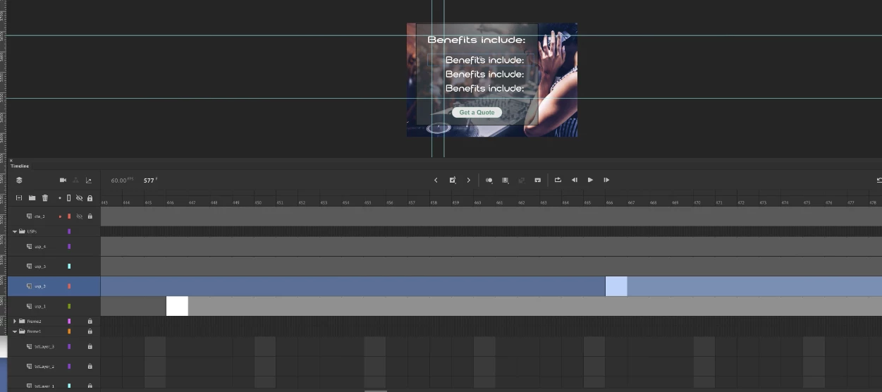

    I've tried redoing the tweens etc but still nothing working. As another guide here are some more images (sorry, I've not posted before so was unaware of best ways to do it).
    Screenshot 1 shows all 4 of the benefits that have appeared at that point in the timeline, but they all show as saying the same thing (which isnt right).
    Screenshot 2 shows me within the scene of the 4th benefit, and as you can see the text is correct and appears fading in as I'd expect. (Note: I've noticed the layer 'LayoutTxt' seems to have the replicated benefit text there, but its a hidden layer, and if I delete it completely not even the text I want (Pre-owned blah blah appears)), however when you go back to the main scene its the wrong text.

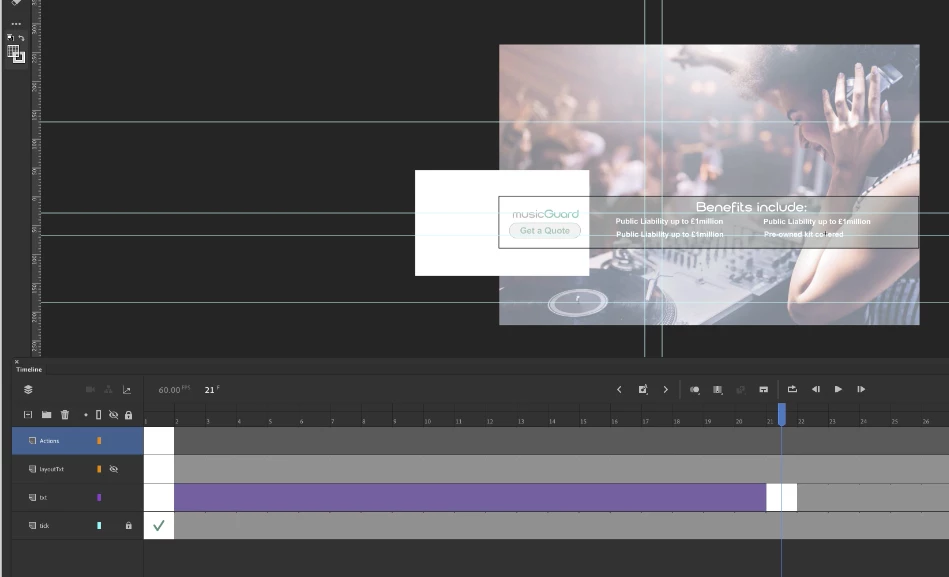

    Screenshot 3 shows what it looks like when I publish and open the html file... so its correct?? Seems very strange, and almost impossible to edit and working on it within Animate shows it wrong!
