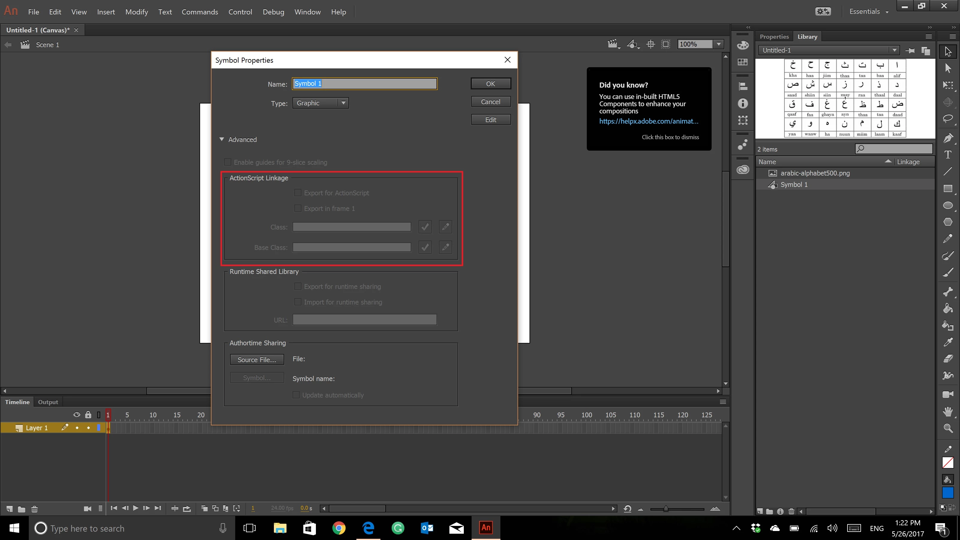

The ActionScript [linkage] box is grayed out. [edited-kglad]
When I want to add a class name from properties of the symbol. The ActionScript linkage box is grayed out and it does not work in Animate CC. I would appreciate your
help in this issue. Thanks.

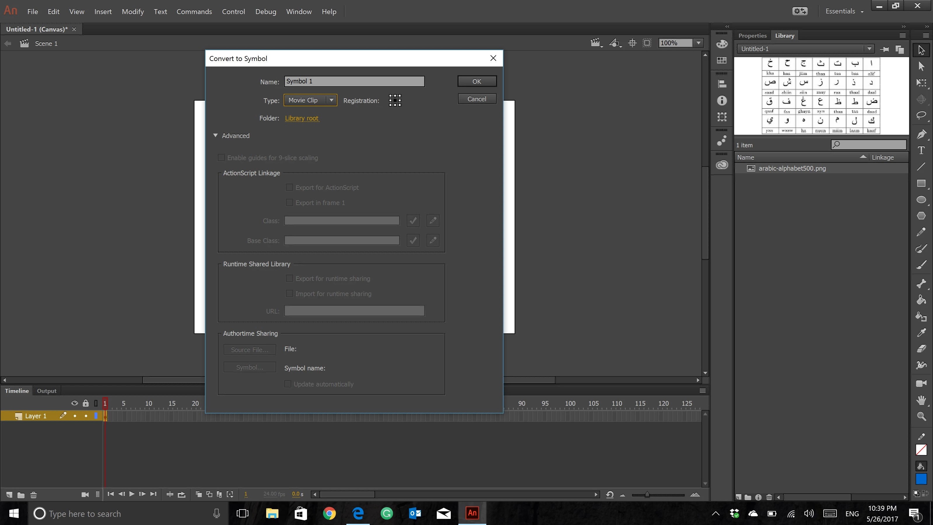

    unfortunately, it does not appear to me as the shot you posted. Here what it looks like in my program.
    That's because you're working in a HTML5 Canvas document, not ActionScript.
    If you want to work with ActionScript, you can use the document type converter by clicking Commands > Convert to Other Document Formats, and selecting the document type that you want.

    Yes i convert to actionscript 3.0 but, still my actionscript linkage box is grayed...

    You have a symbol type of Graphic selected. Graphic symbols to get Actionscript linkage. You'll need to change that symbol to a movieClip or a Button in order to use Actionscript with it.
    May 26, 2017
    I'm guessing you meant "don't get".
