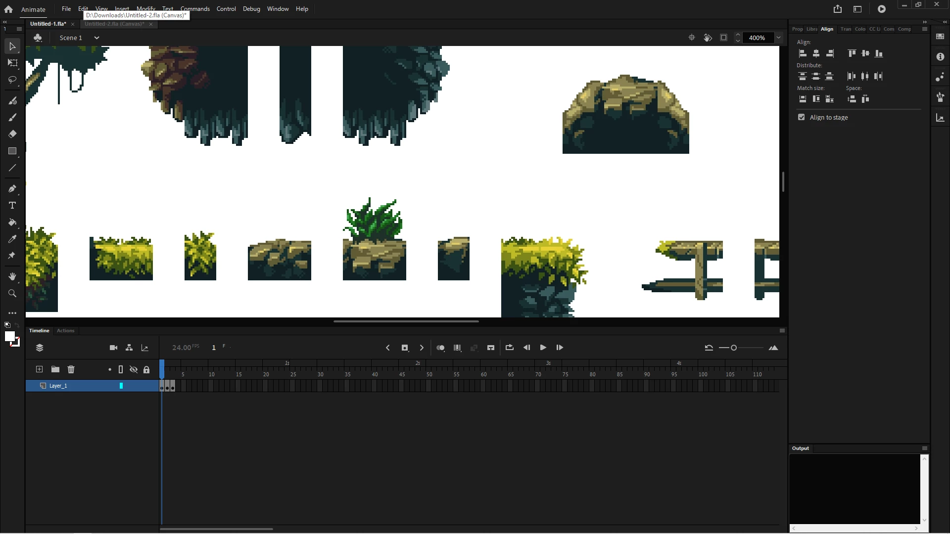

    I tested here and it seems to be working. I'm using the latest public release of Animate (21.0.7).
    - I grabbed a PNG with some pixel art in it;
    - Imported to Animate;
    - Then I went to File > Export > Export Movie...;
    - Set a higher dpi (288);

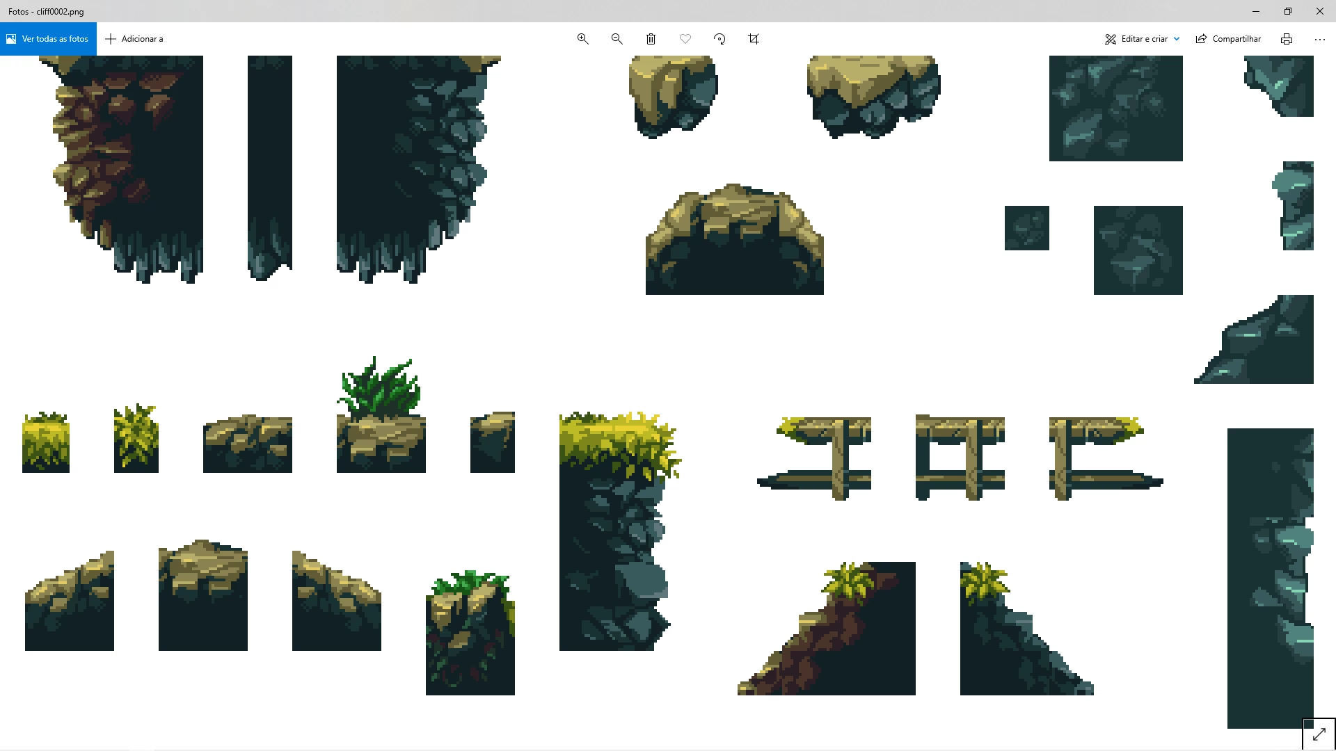

    - And the resulting images remained anti-aliased.
    I ran the test using both AS3 and HTML5 Canvas documents.

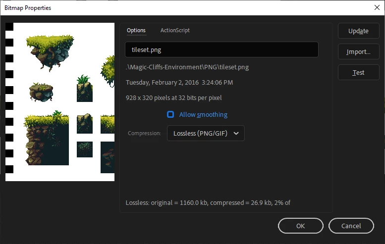

    Also it's important to notice that you must turn off smoothing and set the compression to Lossless (PNG/GIF) in the bitmap properties in the Library.
