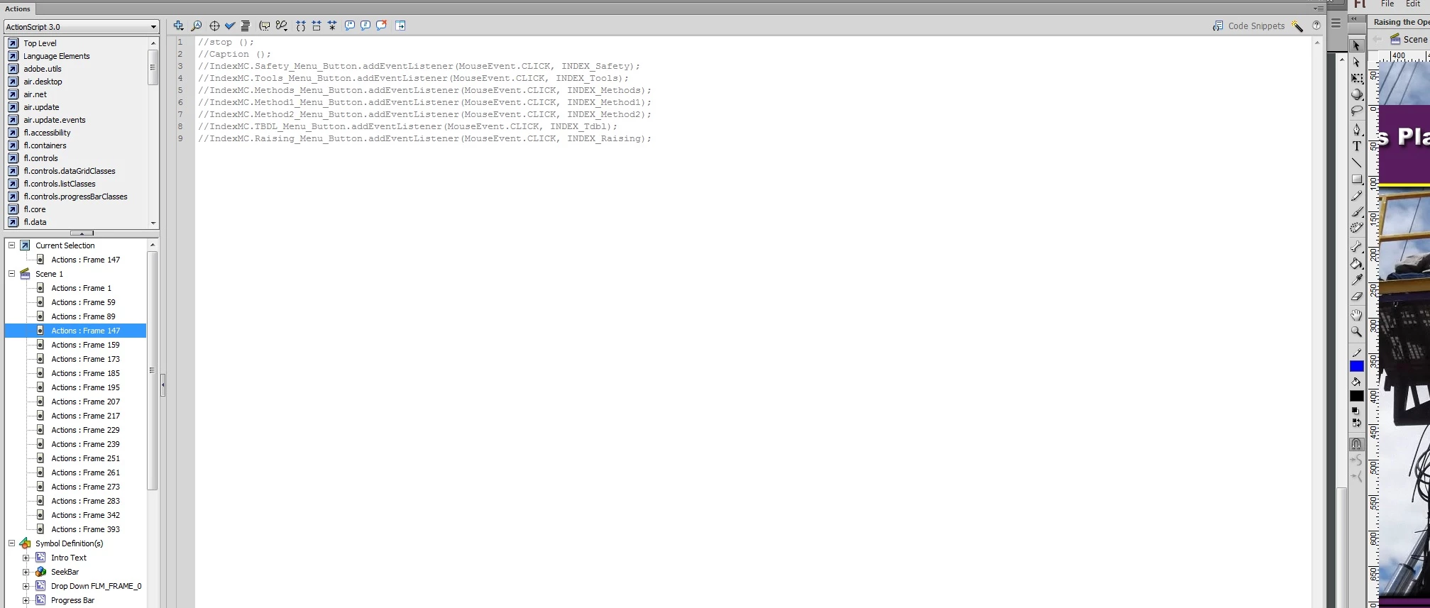

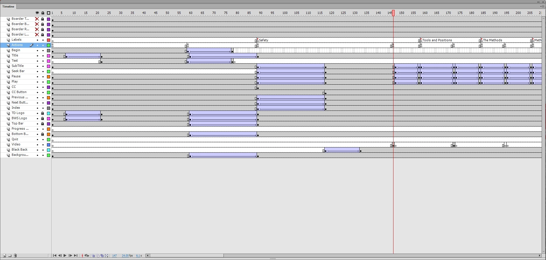

kglad
June 14, 2013
flash thinks you have a 10th line on frame 147.  to find that frame/line:
if you're using scenes, frame numbering starts with the first frame in the first scene. it continues with the first frame in the 2nd scene being added to the frame number of the last frame in the 1st scene etc.
line numbers start with the first line of code in the top-most layer.  line numbering continues in the next layer with code having its first line number added to the last line of code in the top-most layer etc.
so, what code in line 10, frame 147.
JordanDJAuthor
June 14, 2013
that is one of the issues. There is no line 10. I literally only have 9 lines of code in frame 147. I am also only using 1 scene. I dont even have a blank line 10.
kglad
June 14, 2013
attach a screenshot showing all your layers at frame 147.
