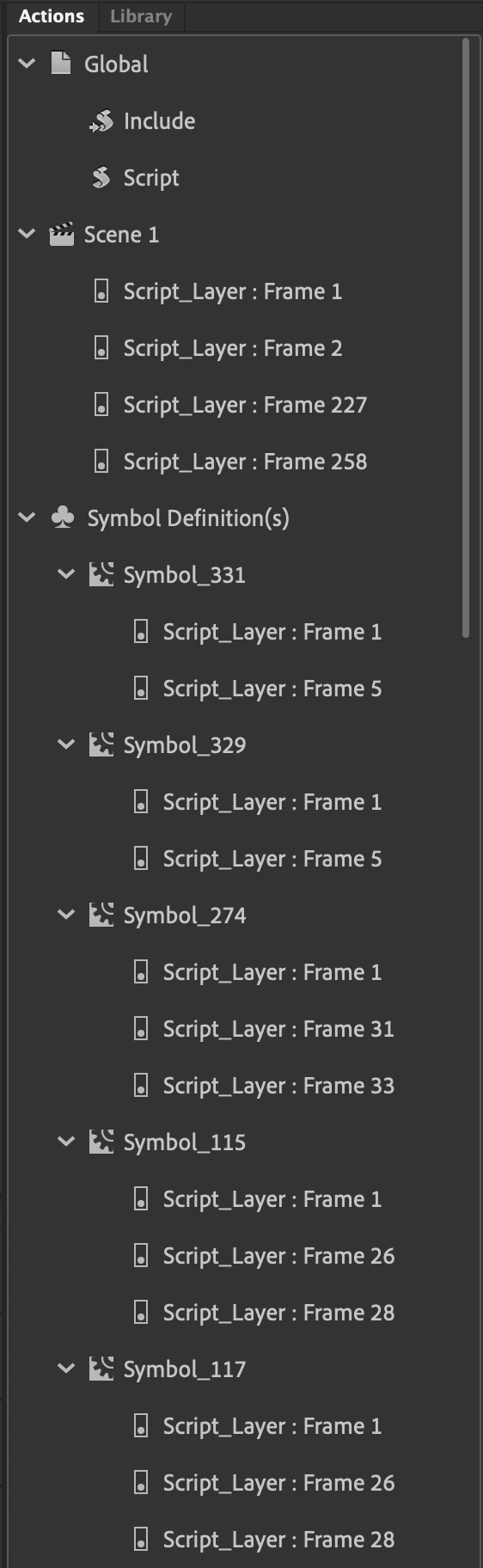

I went into the actions panel and saw all of the AS3 code commented out. The structure I see in the actions panel includes dropdown for global (nothing in there), Scene 1 (there’s only one scene in this project) which has script_layers for four different frames, and then Symbol Definitions, where various symbols have between 2-5 script_layers for different frames.
I put console logs on the script_layers for each symbol. I noticed that I'm only getting console logs on the first frame of each one, and I'd guess that's probably related to why I’m not seeing any of the animations playing. I’ve tried various things based on what I’ve seen on this forum and stackoverflow, but to no avail. But I feel that this should be fairly simple, since the code for all of these script_layers is very short - almost 4 lines each, and does not look complex.

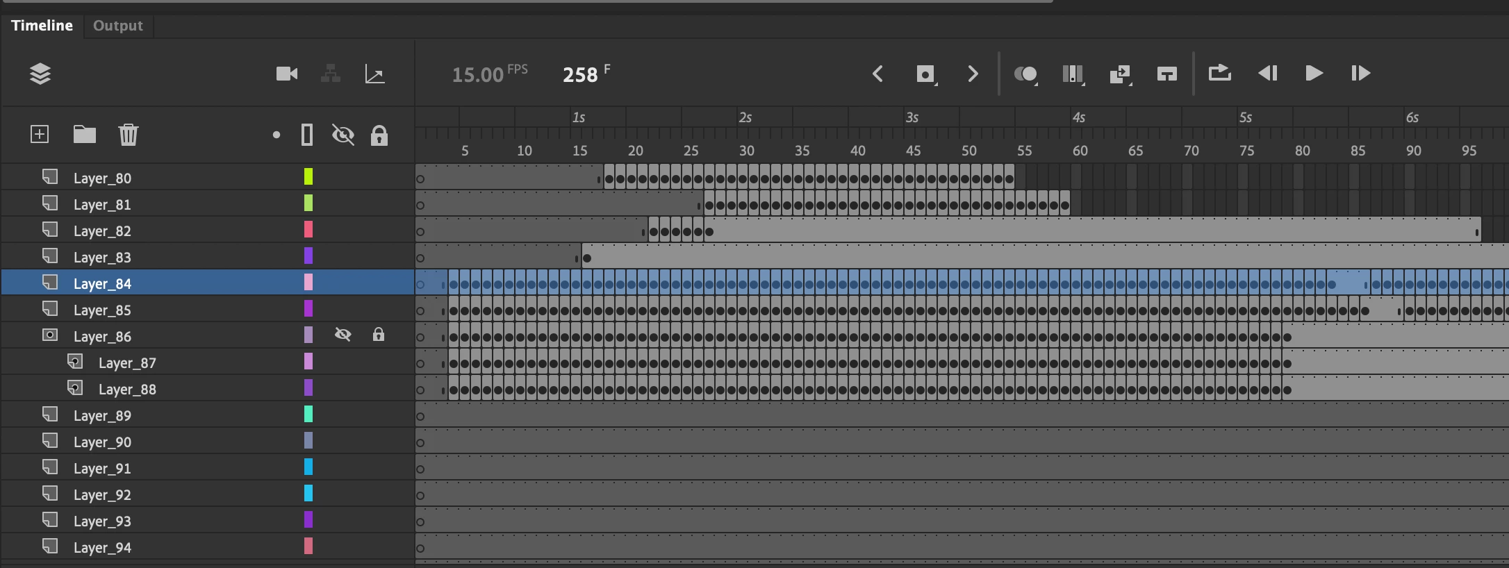

As an example, I’m trying to get one of the earliest movieclips I expect to see animating. Please see attached pictures. On the timeline, this is Layer_84, which has a number of keyframes in it.

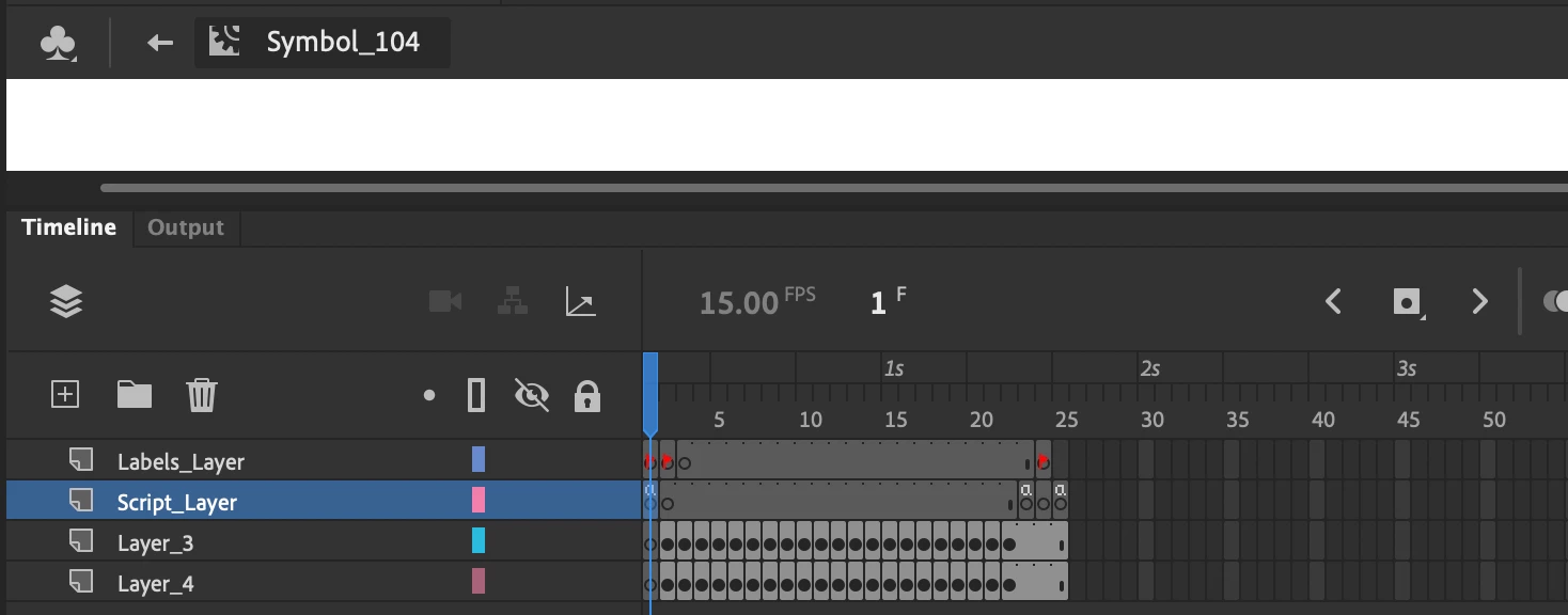

When I click one of the keyframes, it says it is an instance of Symbol_104, a movie clip. It is made up of two other layers, Layer_3 and Layer_4, which are both graphics instances of other symbols.
In the actions panel, I see that Symbol_104 has script_layer code at frames 1, 23, and 25.

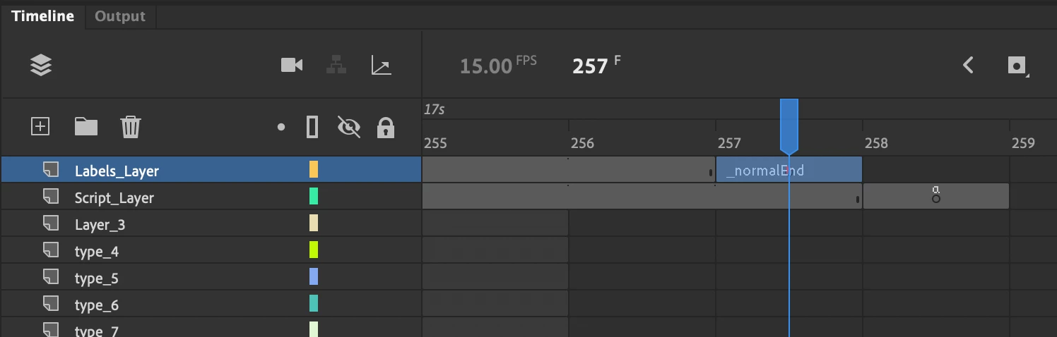

Last thing to note is that these flags _normalStart and _normalEnd seem to be from something called Labels_Layer which I can see in the list of layers for the timeline:
What am I doing wrong? Any help would be appreciated, and thank you for reading this far. I'm at my wit's end!

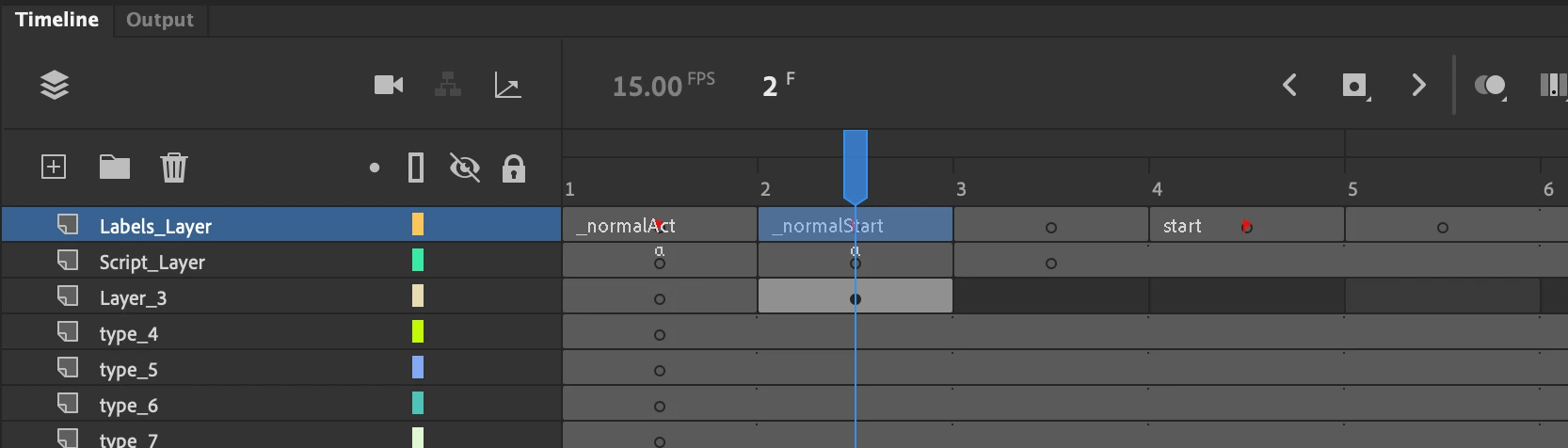

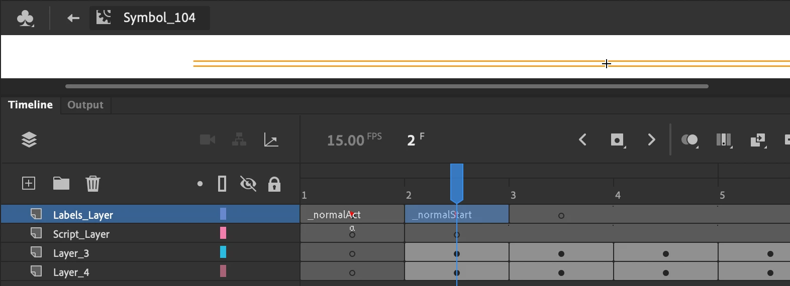

    December 15, 2020
    Oops, one last thing regarding the Labels_Layer. I added a picture of the one on the main timeline, but also realize that these flags exist inside the symbols as well. e.g., Symbol_104 has a Labels_Layer with the _normalStart flag on Frame 2, and _normalEnd on Frame 24.
