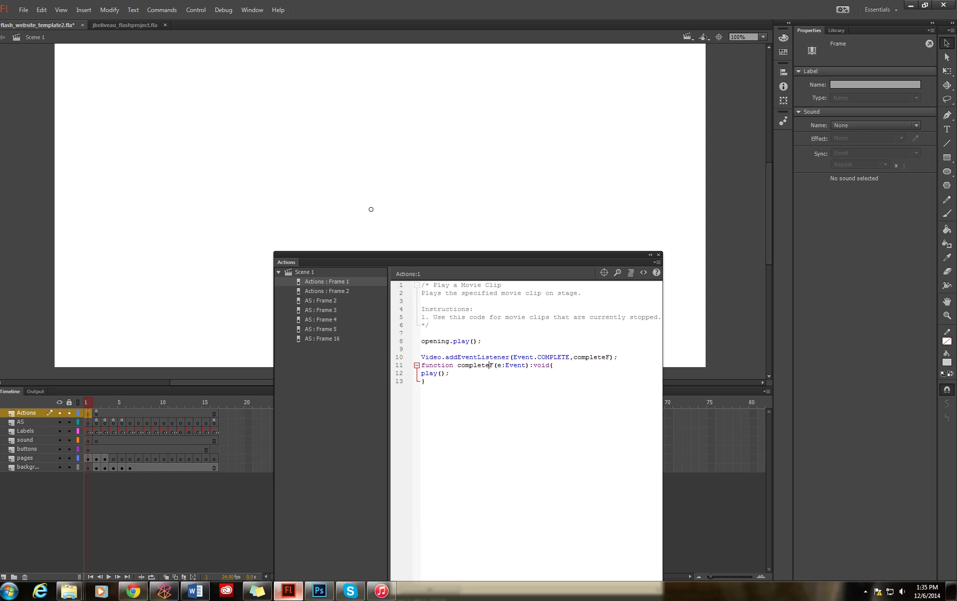

I'm a complete noob when it comes to AS. I know basic things like stop(); and gotoAndPlay.
Here's my dilemma.
Dearest Professor has given us a task of creating a website in Flash. You need to have 15 links, or 15 pages. He states that you can only go frame by frame on the main timeline with no tweening spaces in between. So I'm virtually creating all of my animations in symbols.
This isnt such a problem... I created a short introduction title video in Flash using a Movie Clip Symbol... placed it on the main timeline on the first page, and then called ActionScript to play the video.
Here's the problem... So.... the movie will play, but it will continuously loop... I've tried putting stop(); on the home page, under the AS... I'm just completely lost on how to get this to play the short clip and go straight to the home page... Could someone PLEASE, direct me on how to do this and give me an explanation as to why this way is the way it is... I would very much like to understand how it works.

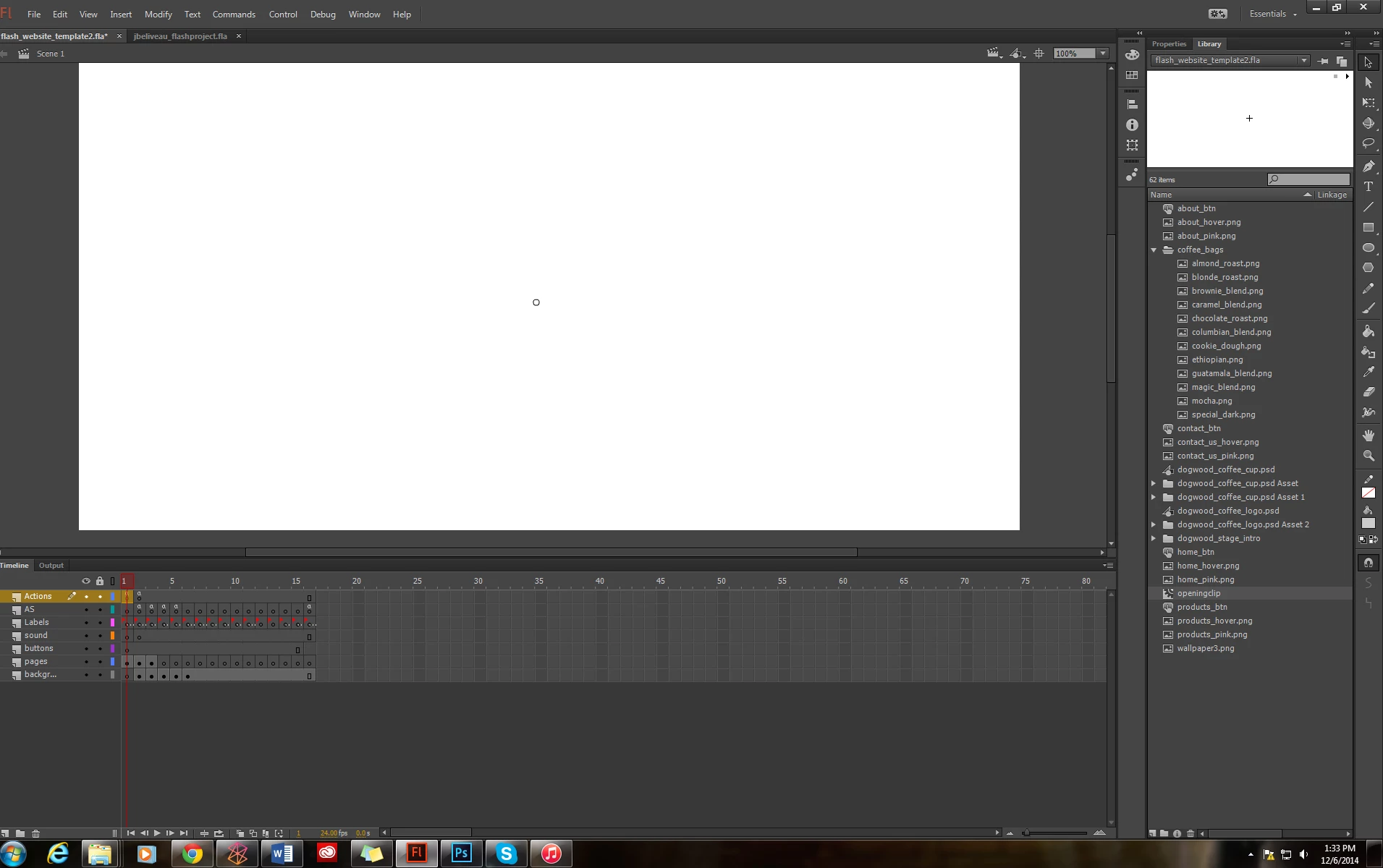

December 6, 2014
Some images to illustrate my dilemma if im just confusing people. @_@
