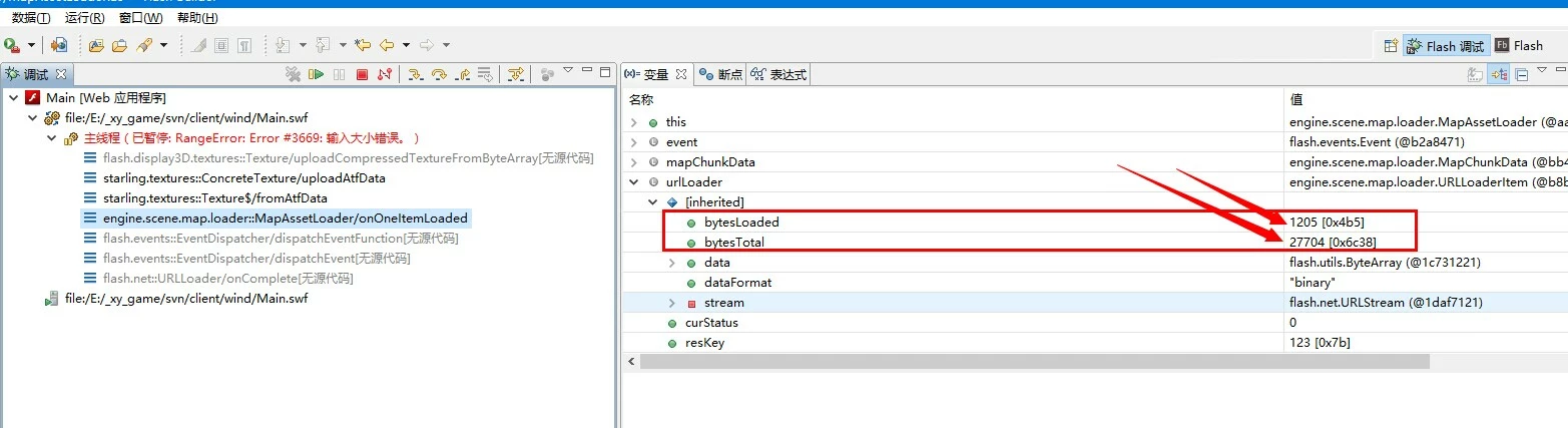

I meet the same trouble. the code was very normal. And it is very easy to turn up when use some tool to limit the net speed .
var urlLoader:URLLoaderItem = new URLLoaderItem();
urlLoader.dataFormat = URLLoaderDataFormat.BINARY;
urlLoader.addEventListener(Event.COMPLETE , onOneItemLoaded );
urlLoader.addEventListener(IOErrorEvent.IO_ERROR , onOneItemIOError );
package engine.scene.map.loader
  import flash.net.URLLoader;
   * 配合MapAssetLoader ,完成地图资源的加载
  public class URLLoaderItem extends URLLoader
  public function URLLoaderItem()
  super();
  public var resKey:int ;
  public var curStatus:int = 0;
