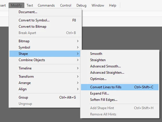

Strokes cannot be used as masks; only fills can.
So animate your stroke, using a Shape Tween to keep the thickness consistent, then convert the stroke to fill so that it can work as a mask.
You achieve this by opening the Modify menu > Shape > Convert Lines to Fills
Hope this helps!

Hi mate,
Hope this helps!

Thanks - that did the trick 😄
