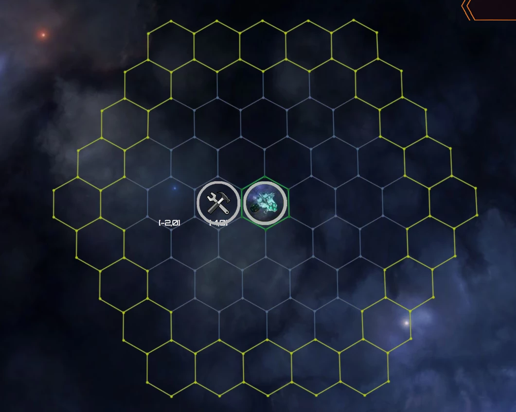

Uhh, not sure how to share my FLA.. But I can probably explain what I'm trying to do a bit better..
I'm trying to create a hexagonal grid of Movie Clips that I can click on to bring up a menu and assign an icon to each position individually.
Currently I have a button for each grid placement with it's own instance name, when I click one it brings up a Pop Menu and sets the var hexTarget to the grid co-ordinate I clicked on, I go through the Pop Menu and select the icon I want in that spot and then it hides the menu and uses the value of the variable hexTarget to point back to that Movie Clip and sets it to the matching frame. (using the code MovieClip(root).Grid_mc.???[hexTarget].gotoAndStop ('matching_Frame')
I've tried swapping ??? for a bunch of different things incl. just putting the entire address in the variable (which I thought would work :S)
All in all I'm trying to get this method to work so I don't have to create a seperate Pop Menu for every grid position, even though I've spent so much time on it now it would have been quicker to do so lol.
Here's an image for reference, cheers
