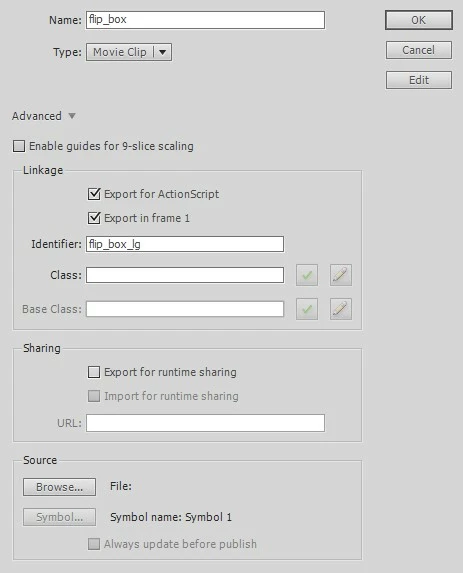

Hello, I am still newbie, i just want to create a very simple thing with the movie clip, i have search through internet for 2 days and found nothing.
So, this is a problem :
-> I have a movie clip name flip_box and in the Frame 1, i add action :
nowtext = "0000";
-> in the frame 15 until 23 -> I have dynamic Text -> Instance name = hitungan
--> in the Frame 15 , I add action :
hitungan.text = nowtext;
and then in the Scene 4
i add action in the Frame 1 :
var box1:MovieClip = _root.attachMovie("flip_box_lg", "fb1", this.getNextHighestDepth(),{_x:100,_y:100});
box1._width = 100;
box1._height = 40;
//_root.box1.nowtext = "50/5";
trace(_root.box1.nowtext);
trace(_root.box1[nowtext]);
trace(_root.box1['nowtext']);
trace(_root.box1.fb1.nowtext);
trace(_root.fb1.nowtext);
trace(_root.box1.flip_box_lg.fb1.nowtext);
trace(_root.flip_box_lg.fb1.nowtext);
trace(_root.flip_box_lg.nowtext);
trace(_root.MovieClip.nowtext);
trace(_root.MovieClip.box1.nowtext);
trace(_root.box1.variable.nowtext);
And this is the photo of the flip_box properties
all the trace is undefined,
i just want to change the Dynamic Text (hitungan) via actionscript
all I wanna to do is Change Dynamic Text inside the Movie Clip that i attach to the stage.
Thanks Before

Could you please give me a code that probably could fix the problem ?
Is my code (writing the as2 about movie clip variable) wrong or there is another problem ?
it's not necessarily a problem.  it's just a matter of understanding how flash works.
as already mentioned, when you create a new instance of flip_box the code in its first frame does NOT instantly execute.  it executes after the movieclip is created.
you could use a delay to assign nowtext after it's assigned on the movieclip's timeline.  eg,
this.onEnterFrame=assignF;
function assignF():Void{
delete this.onEnterFrame;
nowtext="50/5";

what's trace(box1) show?
if undefined, you must publish for fp 7 or better to use getNextHighestDepth and you should be using _root.getNextHighestDepth() because you're attaching that box to _root.
else you have a typo somewhere.

_level0.fb1 -> trace(box1)
[if undefined, you must publish for fp 7 or better to use getNextHighestDepth and you should be using _root.getNextHighestDepth() because you're attaching that box to _root.
else you have a typo somewhere.]
What does it mean ? And how ?
kglad
March 31, 2014
it means there's no nowtext on frame 1 of box1 (or nowtext is a component like a textarea).
