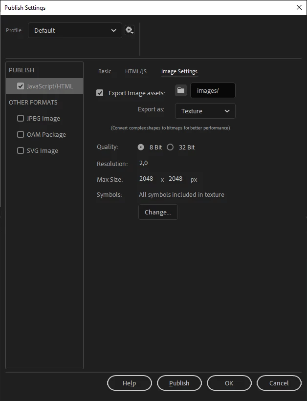

    - Try testing your file with and without exporting the document as texture (Publish Settings > JavaScript/HTML > Image Settings > Export document as texture);

    On the other hand, it turns out that I can't publish under "Texture": the software refuses it. Your colleagues couldn't give me a solution (if you have an idea). When I do it, the page is blank but the file size is indeed considerably reduced. This seems to me to be the solution.
