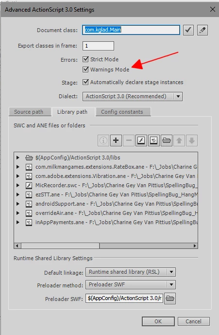

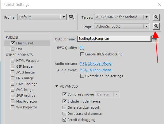

in your publish setting panel click the wrench icon next to as3
then untick the warnings mode
and see if that helps you find your error messages.
