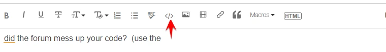

    did the forum mess up your code?  (use the insert code option to prevent that)
    if not, you're using the bitwise ampersand (=&) operator, and you're using it in a way that does not make sense to me.  plus the formatting of your if-statement is incorrect.  that should be:
