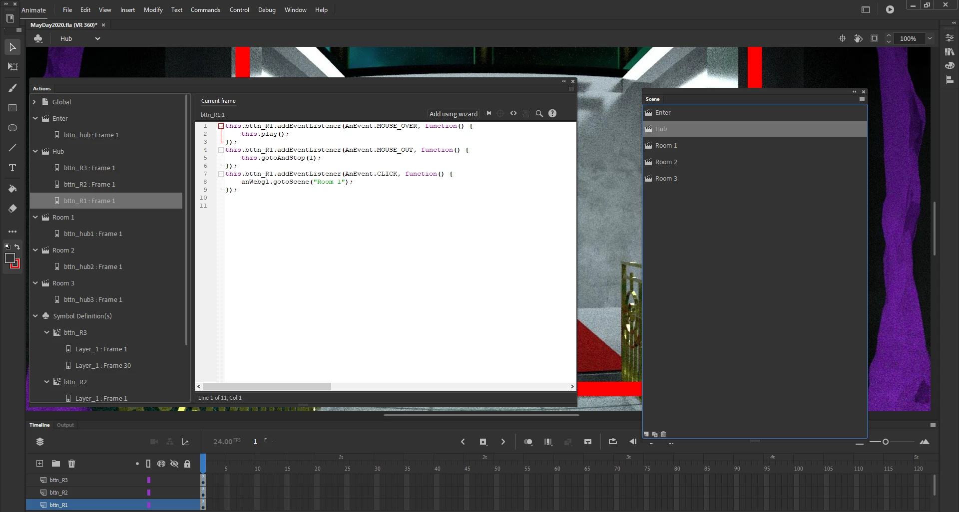

Here is a photo of the Hub scene. There is a button for room1, a button for room2, and a button for room3. In this image you can see the Actionscript for the room 1 button.

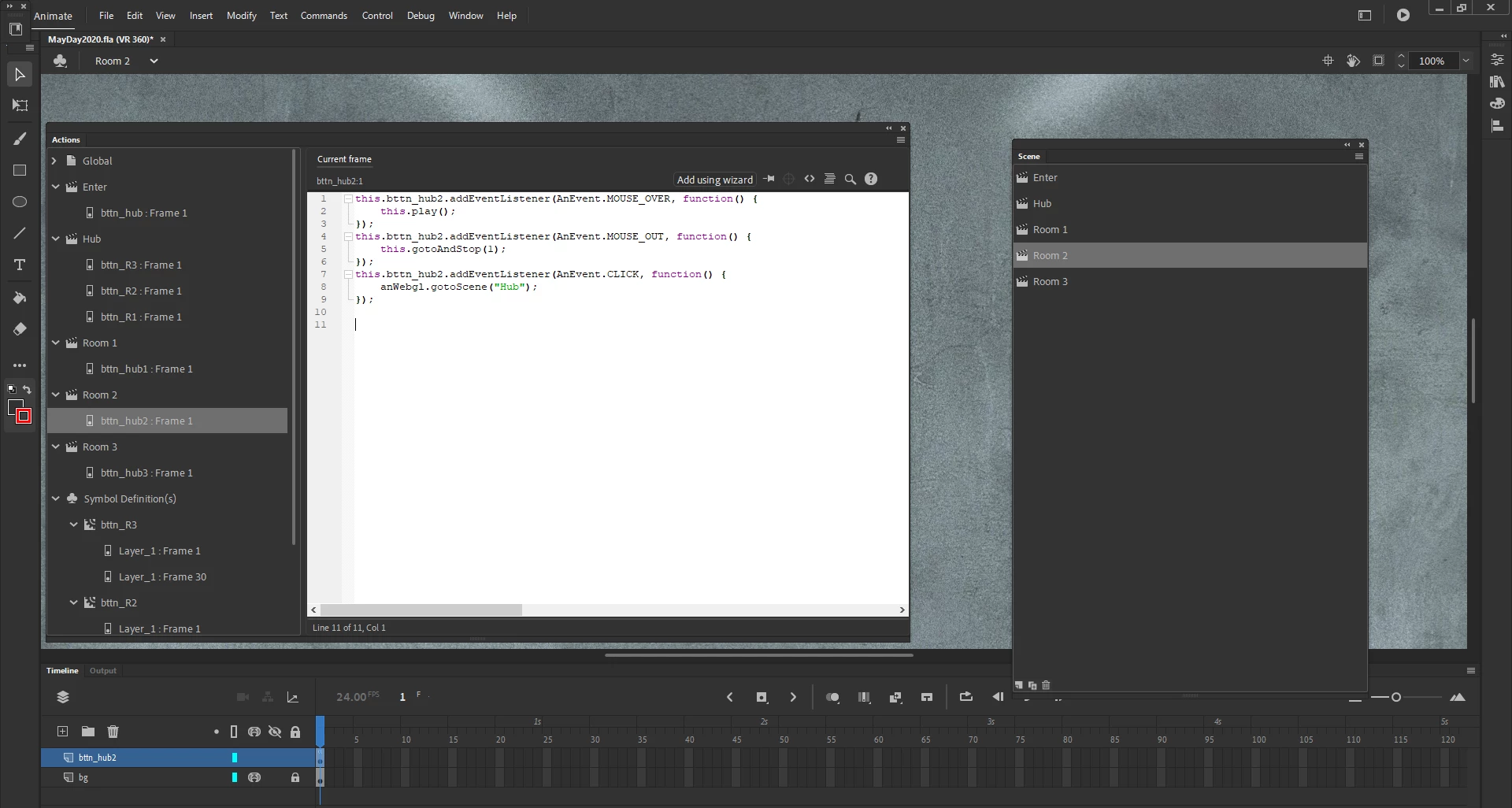

This shows the button in Room 2 that leads back to the hub
