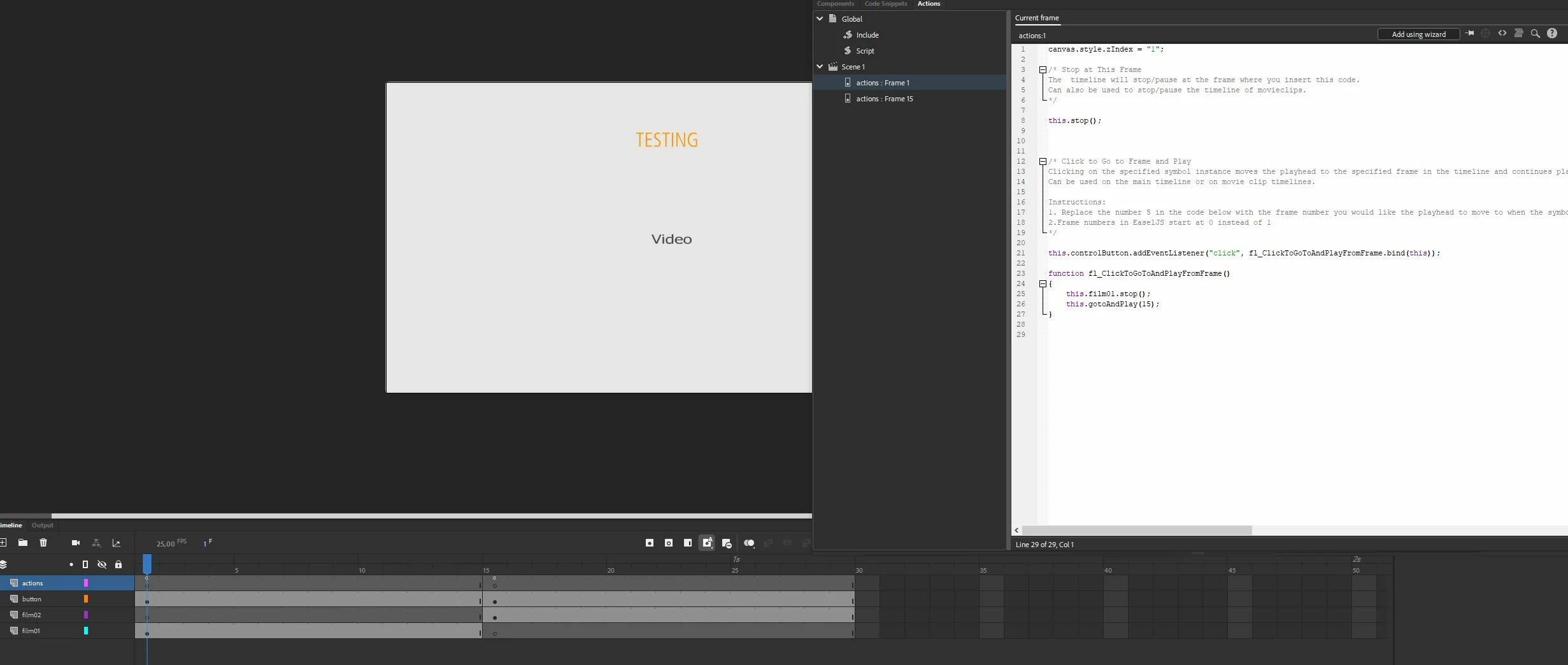

    Nov 22, 2024 9:04 AM UTC
    hi,
    cant get it to work. such an easy thing,  i have no idea why.
    this is the code that i have now. the button goes away after clicking, but the videos neither run, stop nor start...
    the object instance names are controlled and matching. the films are on the c drive and imported as component video
    any idea ? thanks for help !
    tomes
    canvas.style.zIndex = "1";
    // Instanzen zuweisen
    var video1 = this.film01; // Instanz des ersten Videos
    var video2 = this.film02; // Instanz des zweiten Videos
    var controlButton = this.controlButton; // Instanz des Buttons
    // Stelle sicher, dass Video 2 zu Beginn ausgeblendet ist
    video2.visible = false; // Video 2 wird anfangs nicht sichtbar sein
    // Event-Listener für den Button
    controlButton.addEventListener("click", function() {
    // Stopp das erste Video
    video1.stop();
    // Mache Video 1 unsichtbar
    video1.visible = false;
    // Mache Video 2 sichtbar
    video2.visible = true;
    // Starte Video 2
    video2.play();
    // Optional: Button ausblenden oder eine andere Funktion ausführen
    controlButton.visible = false; // Verstecke den Button nach dem Klick

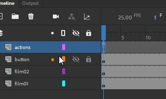

    ROBGAUAuthor
    Nov 22, 2024 12:32 PM UTC
    so it seems  i come a little bit nearer...tough work...
    so film01 runs, button click shows for a half secont the film02 but then directly shows film01 again.
    i tried to end film01 after clicking the button in the script in frame 1 and the same scripting in frame 15 for film 02, but that does not work. ....do i have to maybe reset the "buttonclick" in frame 15 in any way?
    any better idea?
    thanks
    kglad
    Nov 22, 2024 1:58 PM UTC
    does the developer console show any errors?
