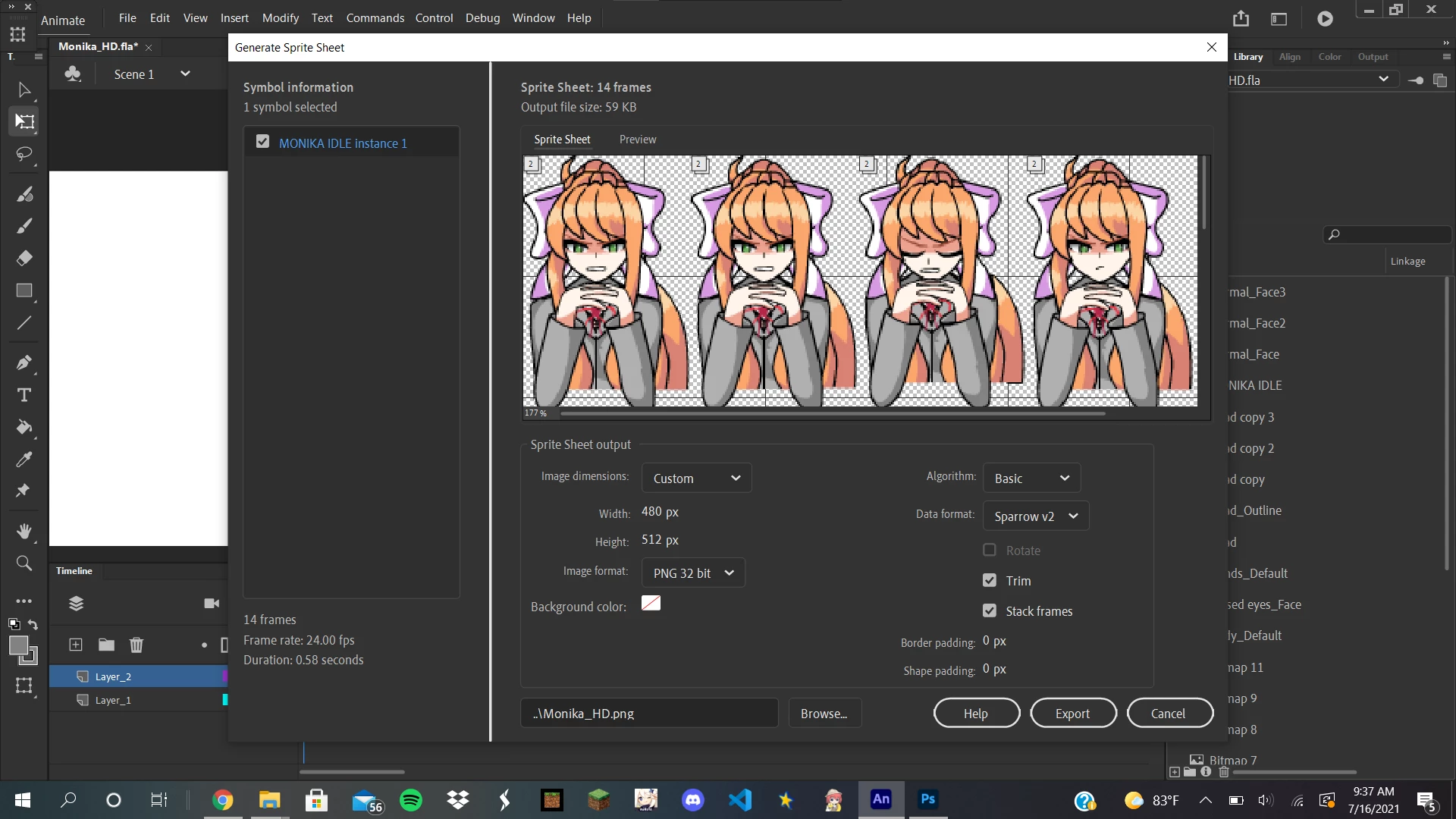

When I export a spirte sheet my drawing turns pixelated
When I export my drawing as a Sprite Sheet or Texture Atlas it turns pixelated. Can someone please help me with this issue it never happend to me before.

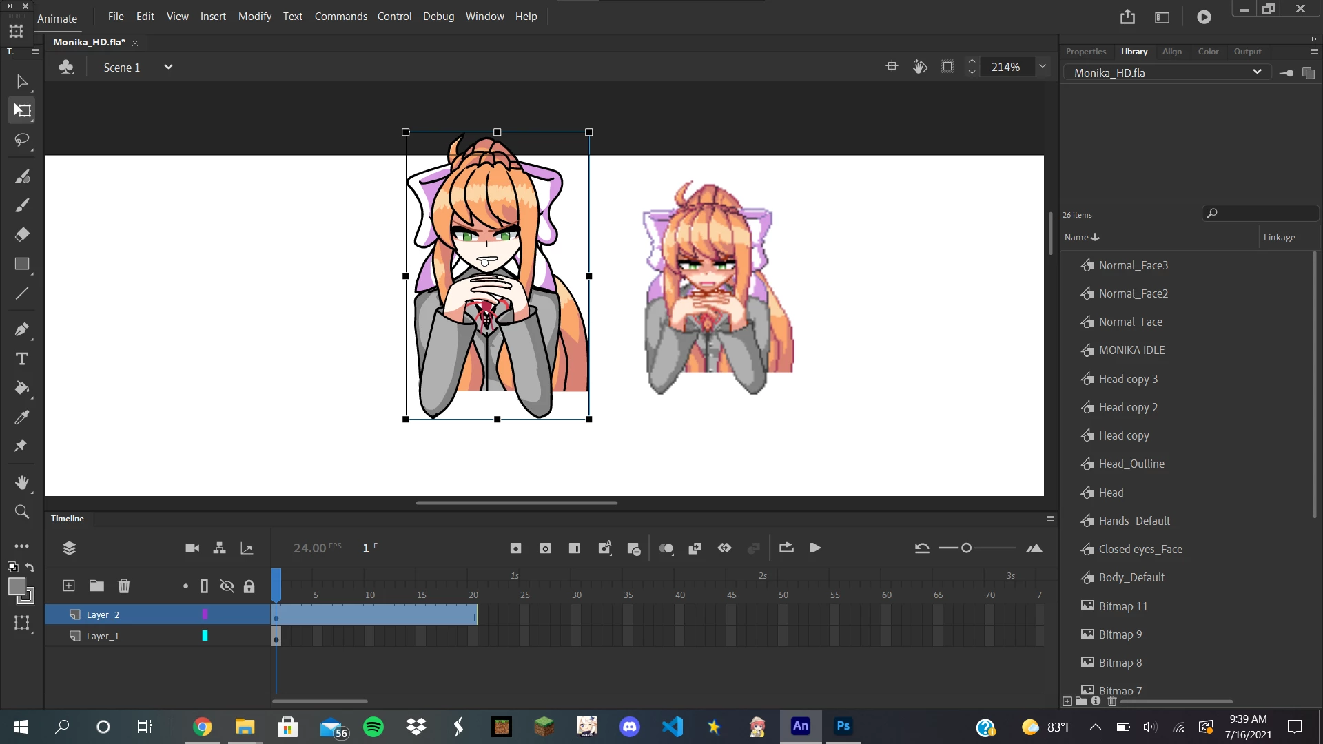

    It's because the png images are too small INSIDE the graphic symbol. You need to scale up every frame of the symbol to make them bigger in the spritesheet.
    Double click the symbol containing the PNGs then select all frames using the Edit Multiple Frames button above the timeline (or press Alt+Shift+E on your keyboard), now scale up the drawings a little with the free transform tool (Q) and try generating the spritesheet again.

    Hugo5CBFAuthor
    Jul 16, 2021 10:36 PM UTC
    Thank You it worked!
