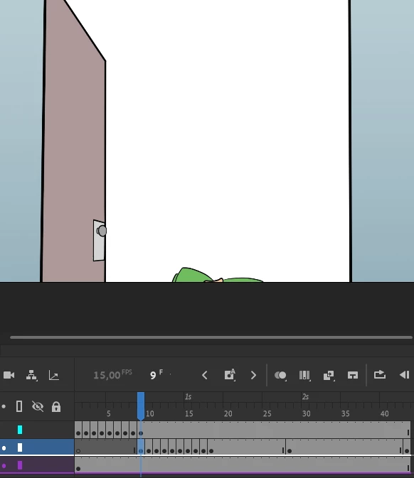

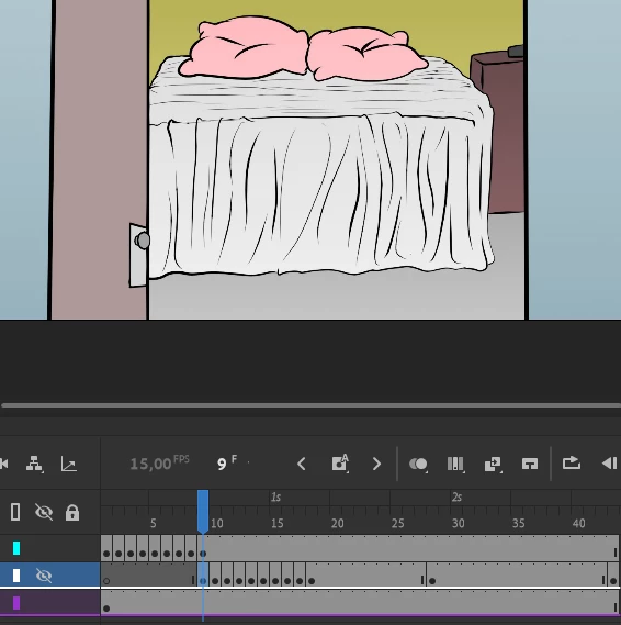

when I import png images a white background is created Help :c
Hello, I have been trying to solve this problem for 3 days.
in adobe animate by having 3 layers filled with png format images the last layer does not appear because layer 2 has a white background that overlaps it, I already confirmed 3 times that the images are png with no background or anything, I don't know why it appears a white background on layer 2 helps 😞

I already found the solution, the error was in my sai 2 program that for some reason exported the png images with a white background even though they were transparent in the program.

Sorry if I didn't make myself understood well, my English is not very good, my problem is that Adobe Animate adds a white background to my png images when I place 3 layers with transparent png images without a white background, I checked all the images and not one has a white background are all transparent, the first layer is the only one that is saved that a white background appears in the images the following layers are added a white background and I don't know why, I import them normally and I don't know why the background appears white.
