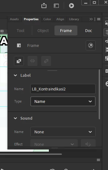

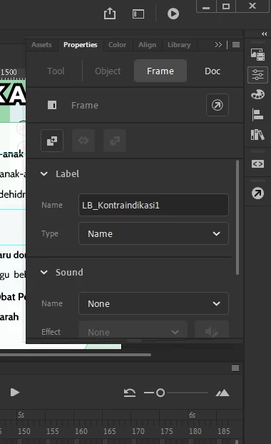

Hello I'm new in Adobe Animate
I wanna create an interactive multimedia using Adobe Animate with HTML5 Canvas,  I use several buttons and labels on other buttons, I don't experience any problems, why can't the code go to Frame and stop be run in this section? I feel that I have used the labels correctly.
here the SS from previous label, I wanna goto next frame, I want to go to the next frame after that label
this.bt_back.addEventListener("click", fl_ClickToGoToAndStopAtFrame_33.bind(this));
function fl_ClickToGoToAndStopAtFrame_33()
this.gotoAndStop("LB_ProsedurBekam");
this.bt_home.addEventListener("click", fl_ClickToGoToAndStopAtFrame_34.bind(this));
function fl_ClickToGoToAndStopAtFrame_34()
this.gotoAndStop("LB_Home");
this.bt_nextmateri.addEventListener("click", fl_ClickToGoToAndStopAtFrame_35.bind(this));
function fl_ClickToGoToAndStopAtFrame_35()
this.gotoAndStop("LB_Kontraindikasi3");
this.bt_backmateri.addEventListener("click", fl_ClickToGoToAndStopAtFrame_41.bind(this));
function fl_ClickToGoToAndStopAtFrame_41()
this.gotoAndStop("LB_Kontraindikasi1");
Here the script I use
thank you for helping me

    you probably need to readd the buttons so they call their listener functions.  to confirm, put a console.log() or alert() in the listener function and see if it's being called.
    September 5, 2024
    Thanks for the suggestion, I'll use that method next time.
    kglad
    September 5, 2024
    yes, that was the problem and yes, console.log() would have confirmed you needed to re-add (or rename) those buttons.

    Are the labels and buttons in the same parent timeline?
    Please let us know.
    JC
    September 5, 2024
    I've found it, it turns out I was using the same instance name on the button so it didn't work, thanks for helping answer
