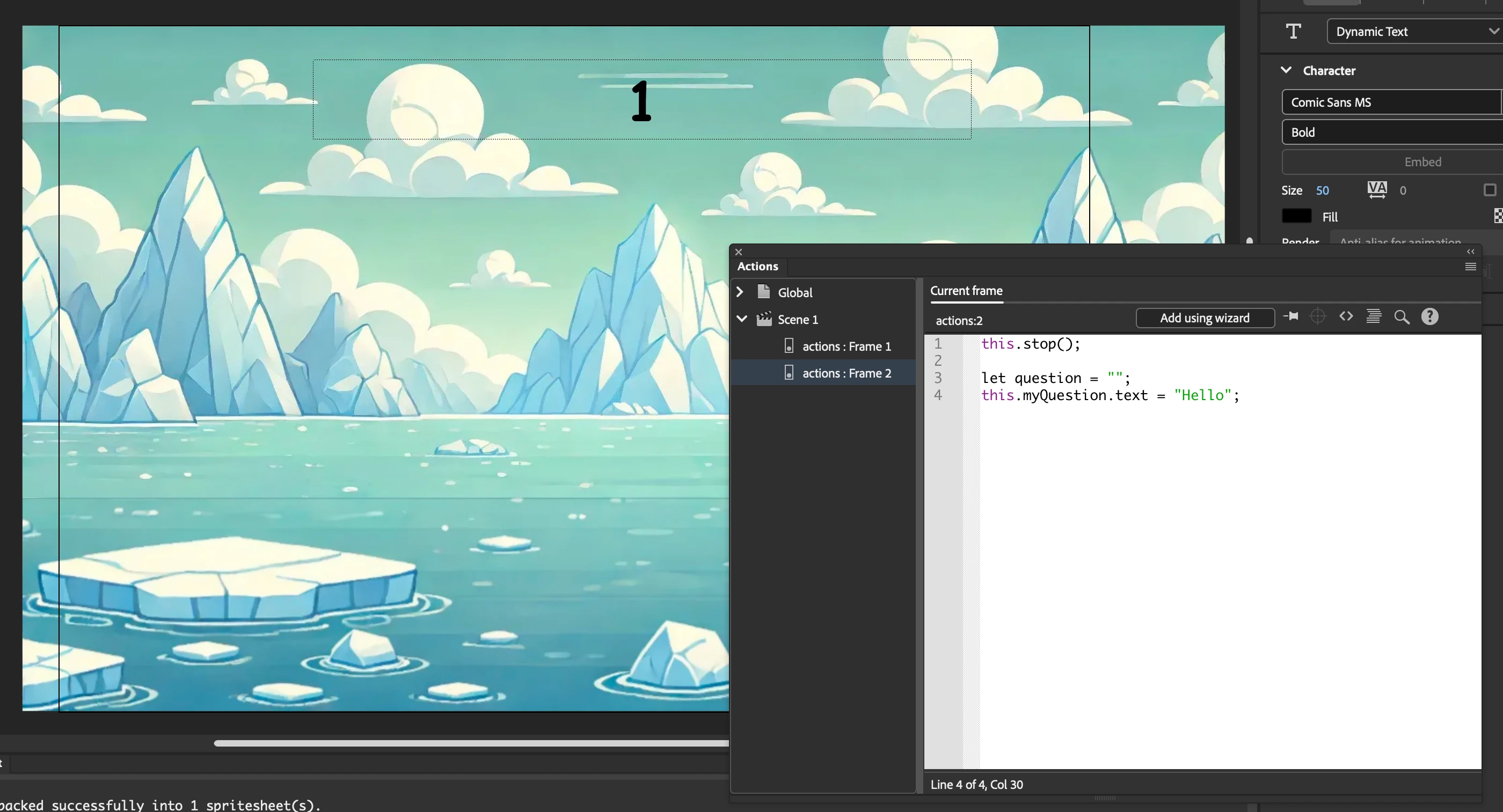

Why my variable is not changed
I have a variable myQuestion but it doesn't display. What problem can be?

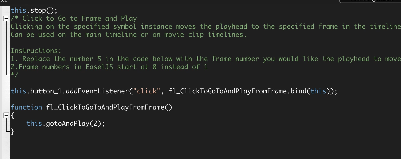

    It should be this.gotoAndStop(1);. In the HTML5 Canvas document, the first frame is 0, then 1, 2, and so on.
    There's no myQuestion text field in the second frame of the main timeline. This text field is inside of another symbol. So you should either remove line 4 - as you also have the same instruction inside of the forementioned symbol - or give a name to this symbol in which you have the text field and change the reference. For example: this.sealAnim.myQuestion.text = "Hello";. // sealAnim would be the name of the Movie Clip that contains the seal animation.
    Oct 17, 2024 6:45 PM UTC
    I removed it from the Frame 2 because it didn't work, so that's why I created it in seal layer. There it works. I want it on the main scene as i feel that in future I will have a problem with the button to go to the main scene from seal layer. I allow you to add text to the main scene to test.

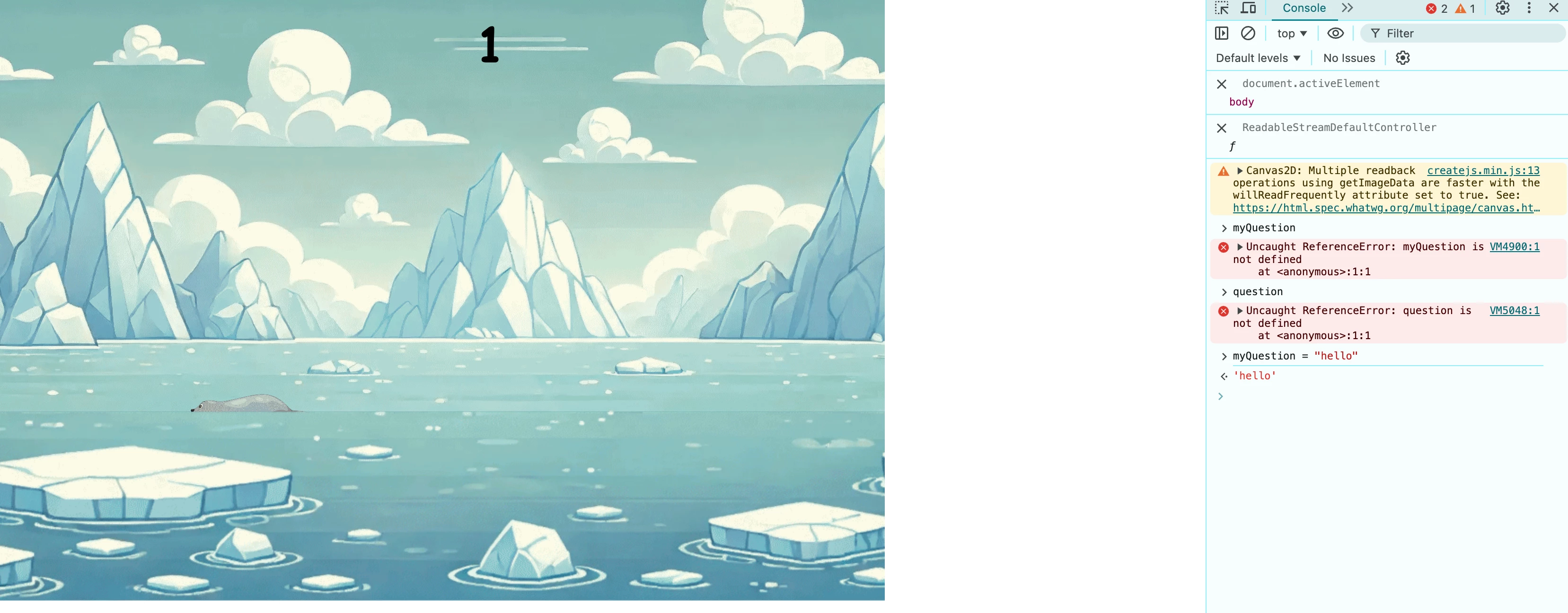

    Oct 16, 2024 6:03 PM UTC
    Hi.
    What do you get if you run console.log(this.myQuestion); on frame 0 and 1 from the main timeline?
    JC
    Oct 16, 2024 7:30 PM UTC
    Hi, the variables are not seen

    you don't have a textfield name myQuestion when that code executes.
