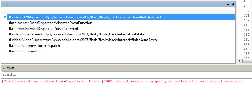

Why would the FLVPlayback class throw a null reference exception from an internal method originating from a timer event?
As far as I can tell, this code path is not originating from within any of my code, so I cannot even determine why it is happening or what is causing it.  Here is the stack trace in FlashDevelop:

I've seen internal 1009 errors when the component is not in the library but the class is imported and it can't find the piece it is trying to target.

you may have an flvplayback component on stage starting to do something but the component is removed before the task is complete.

It's not a library issue; everything is functional under normal circumstances, but these circumstances aren't typical.
I'll investigate to see if kglad's suggestion leads anywhere, because I am stopping/unloading the FLV immediately upon the completion of its download, instead of letting it play to completion as it normally would.  This is part of  an automated testing program.  We have schools across the U.S. using our system and have an automated test program that rapidly runs through part of the program by hooking different events to skip time-consuming tasks like actual playback of FLVs after downloading them and logging the download times.  They simply visit a URL on a lab full of computers all at the same time, and the test program runs through everything (fills in and submits questions, downloads playback files, etc.), which covers all our bases like making sure they have an acceptable version of Flash, that everything is working, and that they have sufficient network bandwidth.
So, I'm not removing anything from the stage, but I am closing the video player very early, immediately after the download completes, as far as I can tell.   My VideoPlayer class (custom class, not Flash's class), handles loading of SWFs and FLVs alike and unifies their events into clear and common events.  I've posted the "unload" code path below, so you can see how it unloads an FLV file. I noticed I have code commented out that used to obtain the internal VideoPlayer object and call close on it, but instead I opted to use the closeVideoPlayer method of the FLVPlayback component, because that's what the documentation says to use.  Perhaps I should switch back to closing the internal video player as well?  Or nulling the "source" property?  Or perhaps there is no way I can avoid this error.

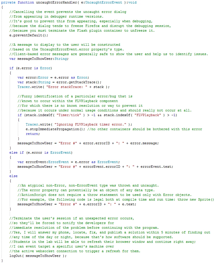

The annoying part is, there's nothing that can be done to prevent the error, since it's occurring in a timer event in a close-source component (FLVPlayback).
The error shouldn't be occurring at all, so my only workaround is to perform a fuzzy match for this particular error on its stack trace in my UncaughtErrorEvent handler: see comment starting with "Fuzzy identification of a particular error/bug..."
