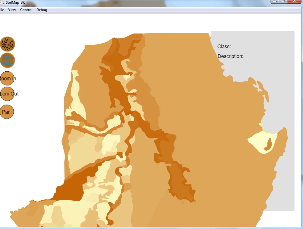

Good Day! I'm new to Flash AS3,
And I have a major problem on my project
What I've been doing is an Interactive map and some functions along with a zoom in/out and pan button
I've got the code on the zoom in/out button, problem is when there is no limitation when I zoomed it in(Still researching this)
Here is my code in the zoom in(I just change the + to - on the zoom out button ofc!)
     on(release){
     _root.SoilMap._xscale+=10;
     _root.SoilMap._yscale+=10;
"I don't have any codes for the Pan Button yet"

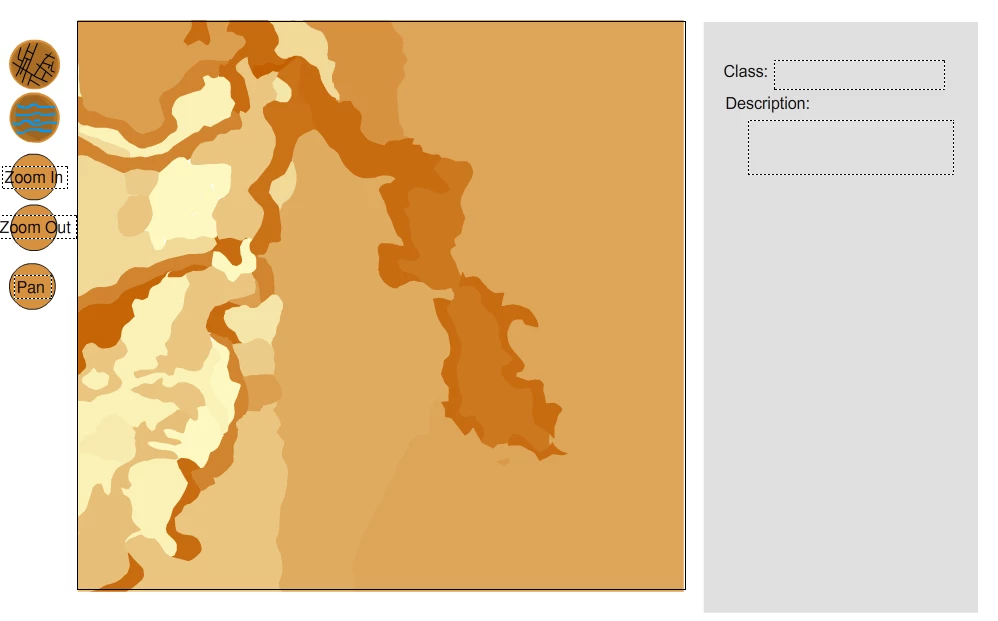

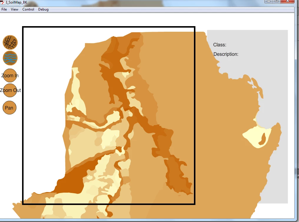

What my final output would be this, in the Black line square that would be my limit in the zoom in/out , and that is the area where
I could only use my Pan button.
Any codes that is related to this would help me.

What my final output would be like this
You could zoom it in and there's no limitationand on the black square that's the area where the pan button is only usable.

And I edited that in paint, lol
