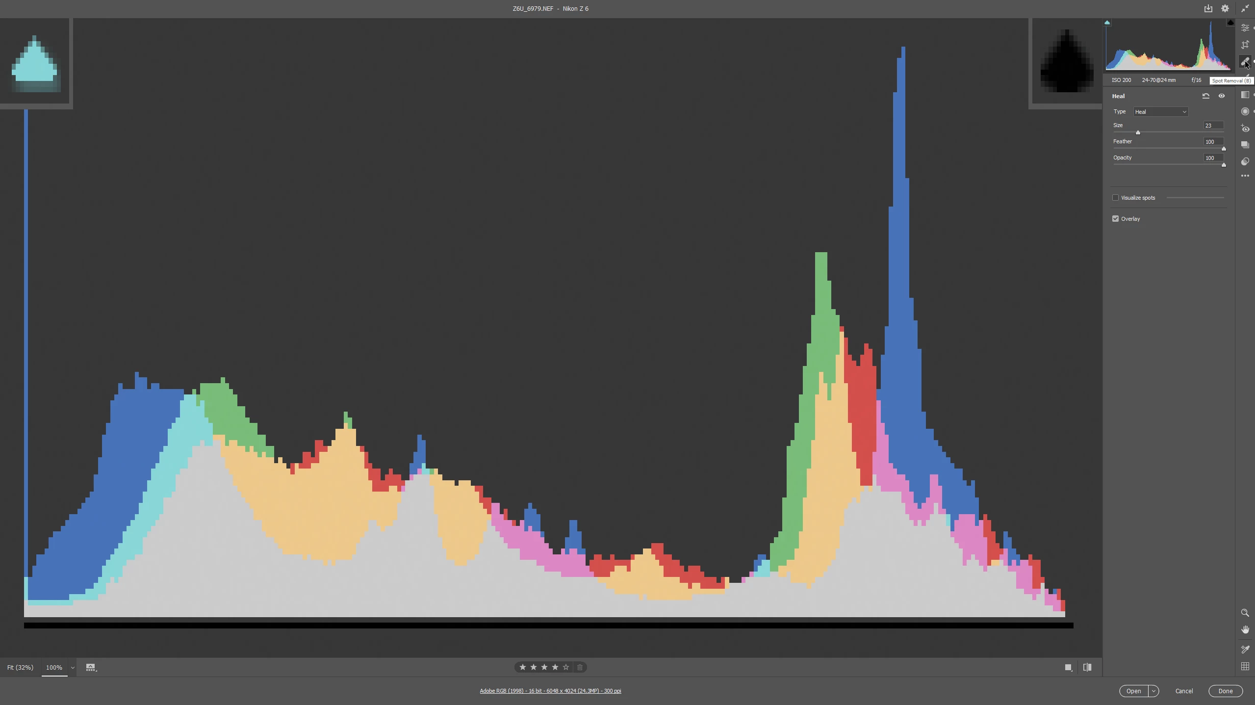

Since installing the Nvidia driver version 460.89, it is no longer possible to work with the current ACR version 13.1.1 and active GPU acceleration. Since I haven't worked with ACR for a long time, I can't tell if the problem also occurred with older versions. As soon as GPU acceleration is deactivated in the ACR settings, ACR behaves as expected.
The error is reproducible: After opening a RAW file from the bridge and activating the Spot Removal Tool, an enlarged view of the histogram is displayed instead of the RAW file.

Which GPU do you have? I use a GTX 1660ti and 460.89 Studio Driver which is the latest. I don't experience any issues at all so I can't point the finger at the driver. Try an older driver perhaps?

I have two RTX 2080 TI installed (for GPU rendering with C4D and Octane/Redshift).
After reading your message this morning, I tried again. To my surprise, I was no longer able to reproduce the problem. The only difference to yesterday's attempt is that the current MS patches were installed on my Windows system last night. Quite strange.
