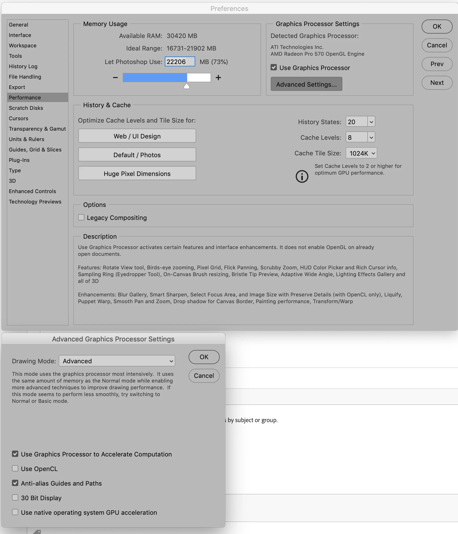

When I open my raw files from Bridge> Open in CameraRaw >  the Adjustment brush is not visible.
When I open my raw files from Bridge> Open > then the brush is visible
How can I correct this so the brush works when Open in CameraRaw?
(It used to work fine until the latest round of Adobe CC and Mac OS updates)
*And here's the kicker, it's not consistent. Sometimes it does work. And sometimes the brush will quit working after having worked .
But I can't find a pattern to the erratic behaviour!!
Except
As I understand it, the first option opens it directly in Camera Raw, and the second opens the file via Photoshop's CameraRaw filter.
I have tried to turn 'Use Graphics Processor' on and off in the Camera Raw prefs and In PS Prefs>Performance.
I've also changed (tried check & un-check) other settings in PS>Prefs to try and increase performance and solve the problem.
I did find these links but still haven't found the answer -
Optimize performance Photoshop CC
Adobe Camera Raw graphics processor (GPU) FAQ and troubleshooting
Photoshop graphics processor (GPU) card FAQ
Troubleshoot Photoshop graphics processor (GPU) and graphics driver issues
Any suggestions appreciated (& thanks to this who may have tried to help last time I posted this.)
Thank you
See inserted screenshot:

This morning (Feb 12) I found an Adobe CC notification that there are updates for PS & Camera Raw (PS 20.0.3 and ACR 11.2) so I have installed them hoping that any corrupt files and/or settings will be corrected.
The first few files Ive opened appear to have the Adjustment brush corrected. I hope it sticks.
I should add that I also removed all login items  (Sys Prefs>User>Logins) in case they were creating an issue
The mystery remains as to why Camera Raw when opened from Bridge directly has the missing/invisible brush, but not the case when opened in PS (Open vs Open in CameraRaw). It is after all the same Camera Raw

I’m sad to report that after working, today the brush disappeared again
i havetried toretrace mysteps totry and see what happened. No luck. I was working on some files and then without warning I selected the adjustment brush but all I got was the cursor. The mystery persists.
please Adobe help figure this out.
August 21, 2019
Now its August 2019 and still the adjustment brush in Camera Raw only shows after restarting Bridge. Not the first time I open a raw file from Bridge >Open in ACR
Ps version 20.06
Br version9.1.0.338
ACR 11.4.0.273
AMD Radeon Pro 570 OpenGL engine card in iMac

Sorry to hear that, have you tried reinstalling the Camera Raw plugin and see if it helps:
Camera Raw plug-in installer
Sahil
February 11, 2019
I just re-installed CameraRaw 11.1
As before (Ive done this more than once) it appears to work.
But then when I reboot the computer its back to square one - no tool visible.
I also just tried again the reset the CameraRaw prefs - no luck.
Also the PS Prefs
