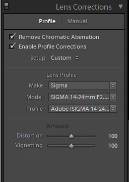

November 22, 2019
When using the original S lenses, the camera will write corrections for distortion and vignetting to the raw file, in a form that Lightroom and Camera Raw understand, and they will be applied automatically
But when using third party lenses, this shouldn't happen.
I have a Nikon Z7 that I use with several non-S lenses, and no corrections are applied for them, but I can do it manually.
Maybe the Techart adapter is causing this behavior.
The screenshot below is for an image taken with the Z7 and a Sigma 14-24mm lens

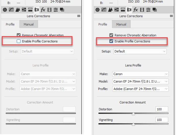

November 21, 2019
Hi
Do you have a sample file? I uses Canon kit , not Nikon, but in ACR I can switch the profile correction separately to CA correction (example below):
Dave
