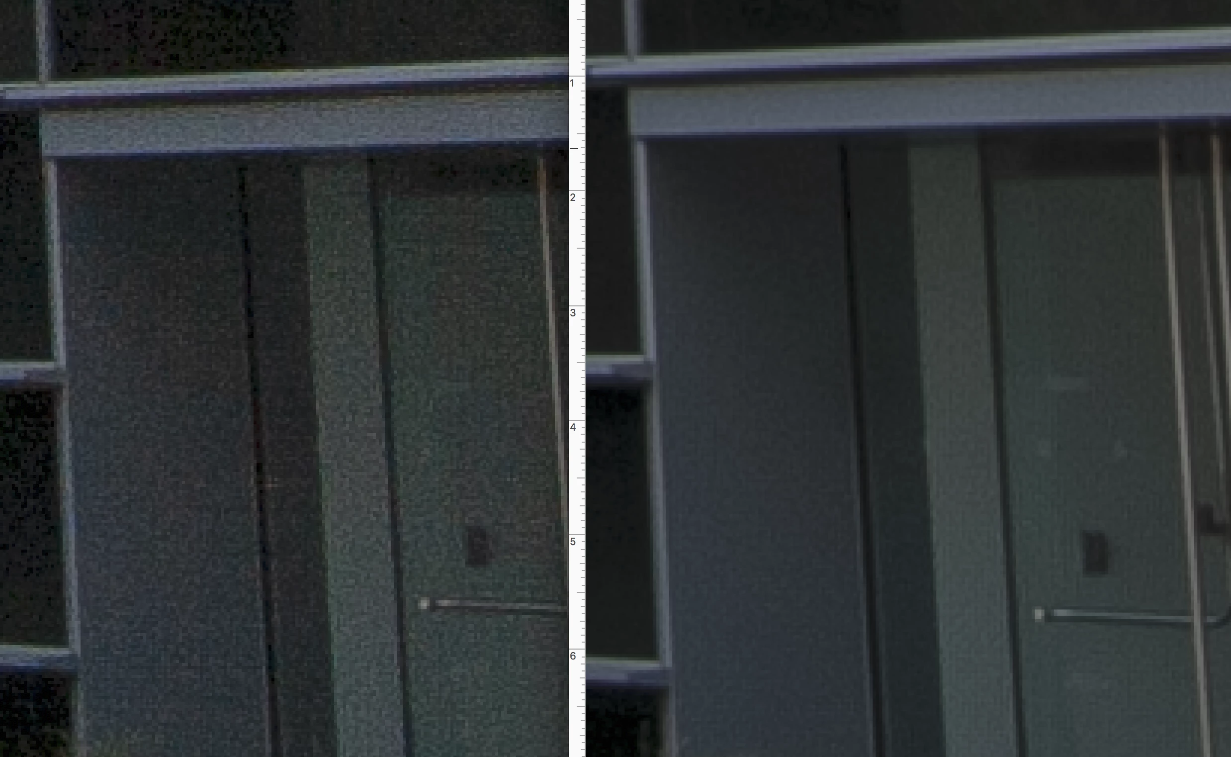

    But, also to compare the "middle" image with the resultant HDR, it is important to zoom into the dark regions of the image and look for noise. Below is what I showed to be a typical case in the test I just did.
    On the left you see the original image. On the right is the HDR version. (Both had the same amount of adjustments applied to both after the HDR conversion. You can see that while the appearance is very similar, the non-HDR (the middle image) is full of noise. The HDR has essentially no noise.
    So there are two issues here: one is that the Auto is not doing the Auto but the process is working (at least with my images). Please try this again with your images and see if the Auto has been activated. If not, manually click the Auto and see if that gets you what you want.
