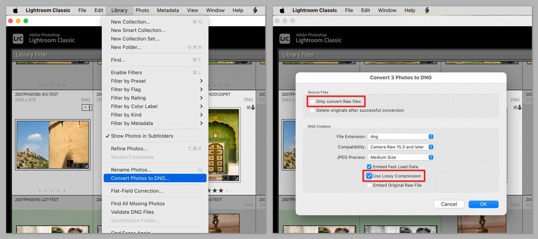

In Lightroom Classic, see if this works for you (try it out on test files first before doing it on irreplaceable images):
1. Select DNG files returned to Lightroom Classic from Topaz.
2. Choose Library > Convert Photos to DNG.
3. In the Convert to DNG dialog box, deselect “Only Convert Raw Files” so that it will process DNG files.
4. Select “Use Lossy Compression”. This option should also be in DNG Converter, and I think you have to select that if you want the file size to go down.
After you click OK, Lightroom Classic (like DNG Converter) will process the images. The big difference with, and the big benefit of, doing it in Lightroom Classic is that it already knows about these images, so it is able to replace them in the catalog without corrupting the catalog. It automatically relinks the database instances of the originals, including existing metadata, to the new DNG copies it made, and unlinks the originals (they no longer appear in the catalog). If you also select “Delete Originals After Successful Conversion, then the originals are deleted; if you don’t select that then they are left in the folder even though they are not visible in the catalog but that would defeat the purpose of saving storage space.
Lossy DNG compression should be almost visually identical to the original. It uses compression that is better than (so, not as degraded as) JPEG compression. However, if it was me, I would not apply lossy DNG compression to images I rate the highest or which must retain as much quality as possible because I want to make large prints or something. But there should be no visible quality loss for images that will only be printed small or posted to social media, for example; so I would have no problem applying lossy DNG compression to those.
