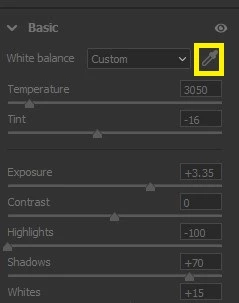

I have to add my 2 cents to agree with every complaint I am reading. I will say CRZ 12.3 adds a few useful (to me) tools but the disappearance or complication of old standards should shame Adobe for all the reasons other posters note.
I cannot find the eyedropper thing-y that used to live in the toolbar. It permitted one to click at a point in the image so that doing so rendered that point as neutral middle gray -- RGB 128/128/128. If that is still available in 12.3 somebody please tell me where.
That defect alone is enough to downgrade. But it is enraging that useful new tools then are out of reach.
JP Hess
Aug 2, 2020 10:56 PM UTC
The white balance "eyedropper" tool is right next to the white balance drop down selector.
