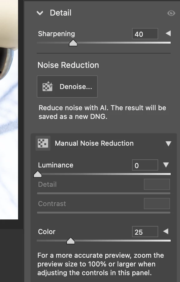

Having just updated Camera RAW to15.3, and instantly witshed i hadn't!!apparently my graphics card doesn't support the new Denoise function, and will take up to 15 mins to carry out a function that took miliseconds with a slider...Really can't see the point of that, except as part of a bigger scheme to get rid of photographers and replace us with AI images!!

"apparently my graphics card doesn't support the new Denoise function, and will take up to 15 mins to carry out a function that took miliseconds with a slider...Really can't see the point of that"
The Legacy Denoise sliders are still there.  If you hardware is not adequate for the new GPU-intensive Denoise - then you are better served using the older tools and not downgrading. When you downgrade you remove bug and performance fixes.
For modern hardware AI Denoise takes seconds - not minutes.
May 8, 2023 3:39 PM UTC
Thank you for your reply. the drop box you shared in different to the one in my camera RAW, The faded out detail and contrast sliders are not visable on mine. for the level of my needs, the older version did what I want, so have elected to go back a version. The So caled bugs did not effect my work, so happy to carry on using the older system.
