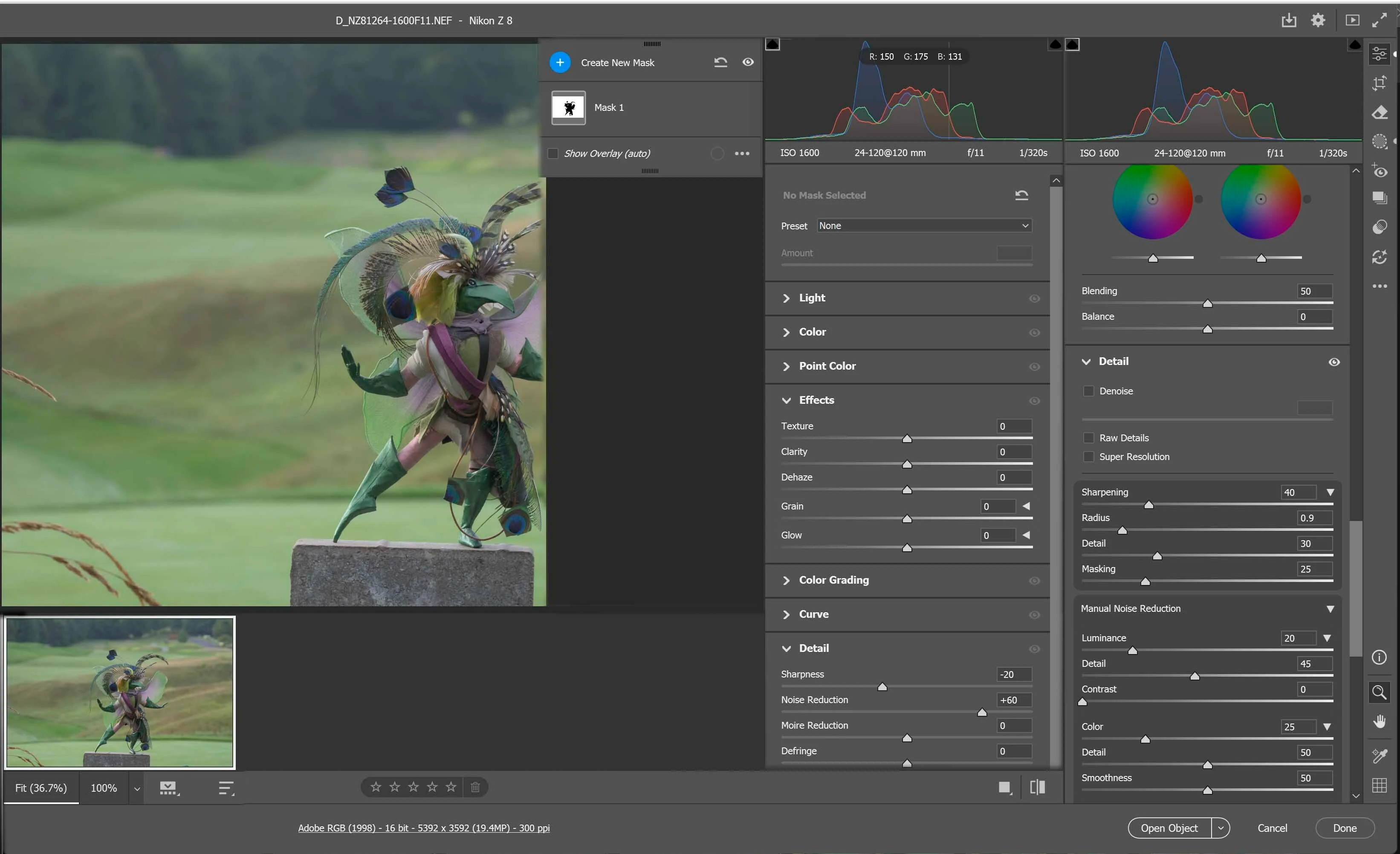

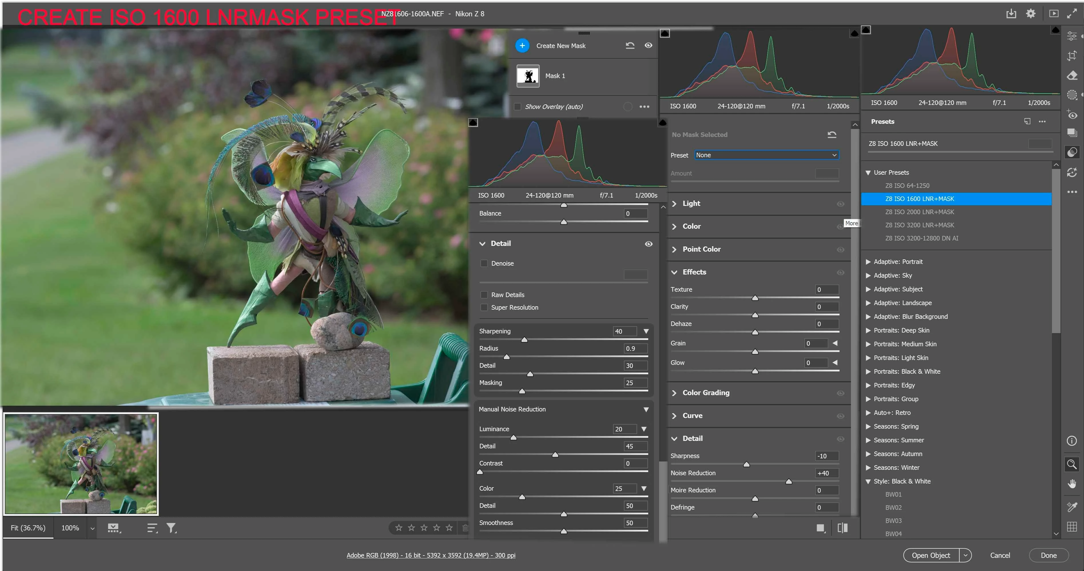

  1. Create an ISO 1600 LNR+MASK preset with:
    • Local Background Mask Sharpening = −10
    • Local Background Mask Noise Reduction = 40
  2. Test the ISO 1600 preset on multiple different ISO 1600 photos.
    • All photos correctly receive −10 / 40.

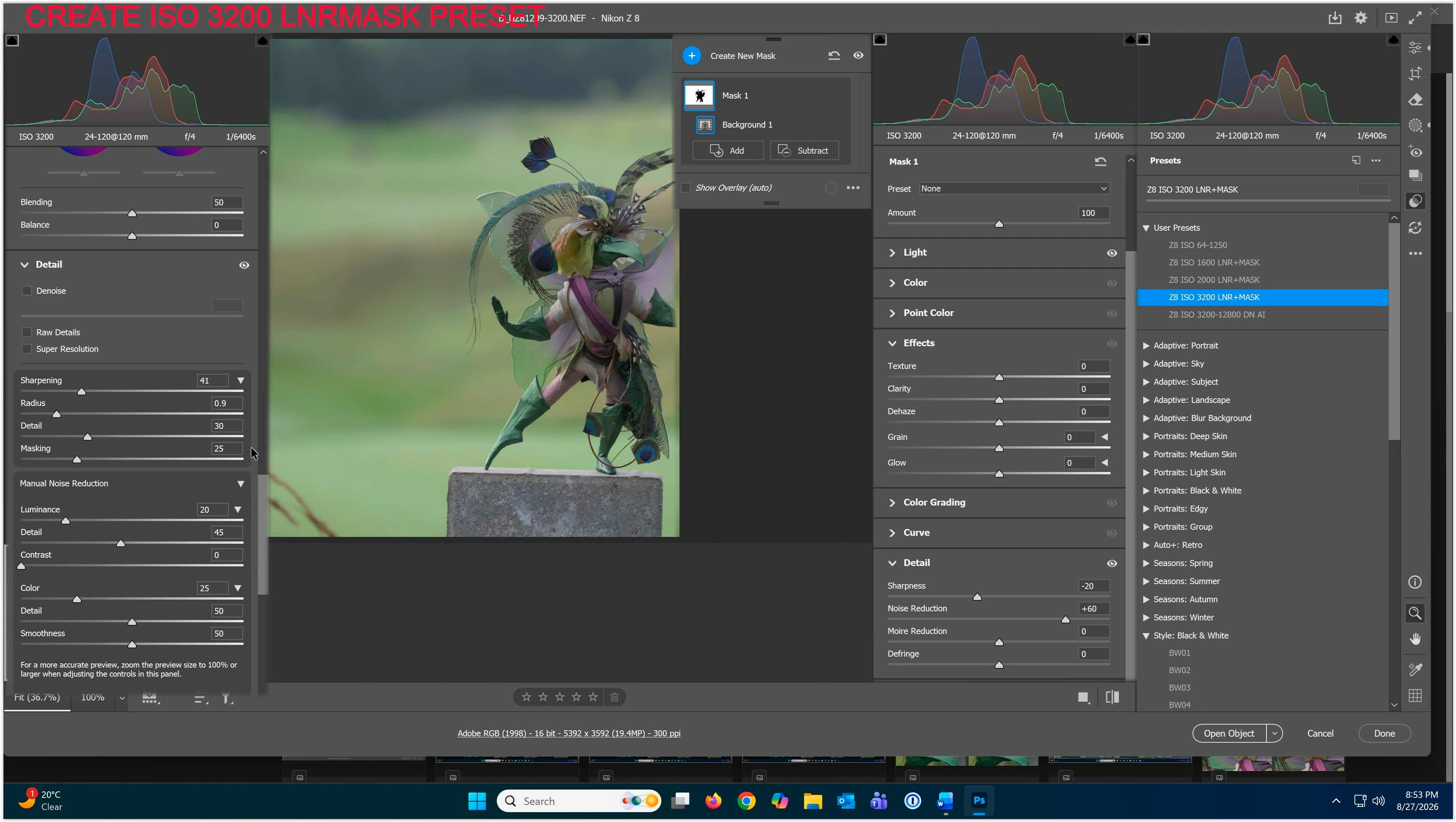

  3. Create a second ISO 3200 LNR+MASK preset with:
    • Local Background Mask Sharpening = −20
    • Local Background Mask Noise Reduction = 60
  4. Test the ISO 3200 preset on multiple different ISO 3200 photos.
    • All photos correctly receive −20 / 60.
  5. Return to other ISO 1600 photos and activate the ISO 1600 LNR+MASK preset.
    • The global Sharpening/Detail/Masking settings are correct for ISO 1600.
    • However, the Local Background Mask now incorrectly shows −20 / 60, which are the Local Mask values from the ISO 3200 preset.

I have attached 3 jpeg showing the above sequence creating the two ISO Pesets , and the 3rd jpeg shows the corrupted ISO 1600 Preset with the  values from ISO 3200 preset
