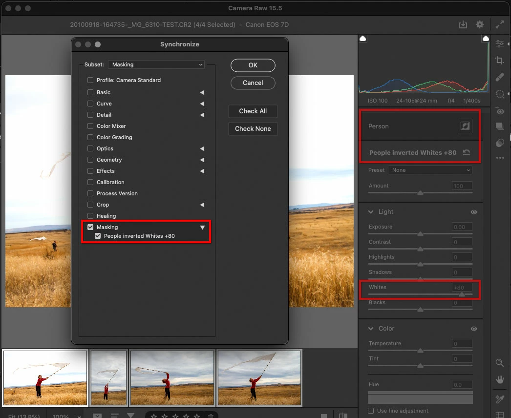

Coud this be taken care of by combining AI masks and Sync Settings/Copy and Paste Settings? I ask because AI masks, such as People masks, auto-adapt to images they are synced to. If it works, it would work like this:
1. On a sample image, such as the first in a set, create a People mask, and invert it.
2. With that mask selected, increase Whites by +80.
3. Select any number of other images.
4. Use the Sync Settings or Copy/Paste settings command to apply the same mask to the other images.
Because the People mask is an AI mask, if the person is easy enough for the AI to identify in the other images, Camera Raw will use AI to automatically adapt the people mask to the shapes of the people detected in the other images.
Is there a reason you need to use a brush adjustment at all? The problem with the brush is that it’s manually painted, so it will not adapt to changing content positions in other images. But the AI-based object and people masks should auto-adapt, reducing or (if you’re lucky) eliminating the need to manually paint anything.
If it works, and if you do this a lot, you want to save that mask as part of a preset, so that in the future, you would only have to select a bunch of photos in Camera Raw and apply that mask preset, and if the AI People mask auto-adapts reliably, you’re done.

It should have worked. How did you set up the preset with the mask? It worked when I tried a test preset with a People mask in it.
