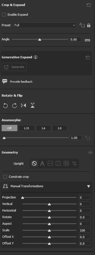

Please can someone explain the changes to the crop tool in Camera Raw (18.3)?
When using the gemoetry options I cannot crop to the edge of the image no matter what I do - this was no problem before. When the crop area is maximised, the crop tool no longer drags the cropped area, it only draws a new area to crop.
This is incredibly frustrating. Please can someone tell me how to get the legacy crop tool back? This wasn’t included in any “What’s New” content I have seen.

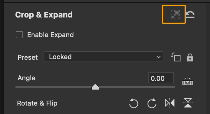

    Ahh - ok all, I have found the solution. The CONSTRAIN function IS there. It’s much harder to find, and I’m not sure it’s syncable yet (will test) but it is right at the top, next to the ‘undo’ button in the crop and expand portion - wow - quite a change, but thankful it’s there. THANK YOU ADOBE
    Jul 14, 2026 11:00 PM UTC
    yes, it is syncable, at least in images that leave blank space. Still testing

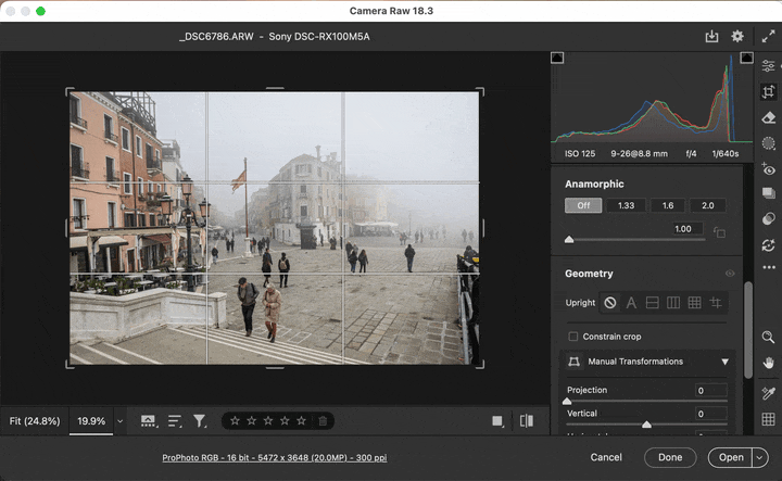

    Apr 24, 2026 10:05 AM UTC
    ...and what does it look like now?
    Some changes and additional features but, as far as I can see, the function of the crop tool is the same as the previous version.
    This is version 18.3.0.2528:
    Apr 24, 2026 4:13 PM UTC
    Yes - it looks like that, but as I say, using the geometry options now change the function of the clicking and dragging the image, with no option to move the image 😓
    I think what’s happened is that the full transformed image is now shown around the cropped area, whereas previously it was just cropped to the visible image within the original/selected ratio. Just an odd change that I guess I’ll have to get used to, but it is odd it won’t crop to the edge of the transformed image...

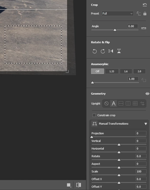

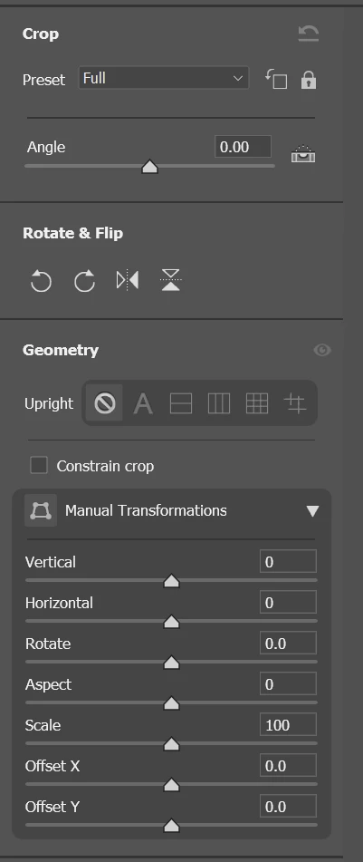

    I am unaware of any changes to the Crop  Tool in 18.3. Could I ask which version you were using prior to your update?
    Apr 23, 2026 11:06 PM UTC
    It was Camera Raw 18.2.3, where the UI panel looked like this
