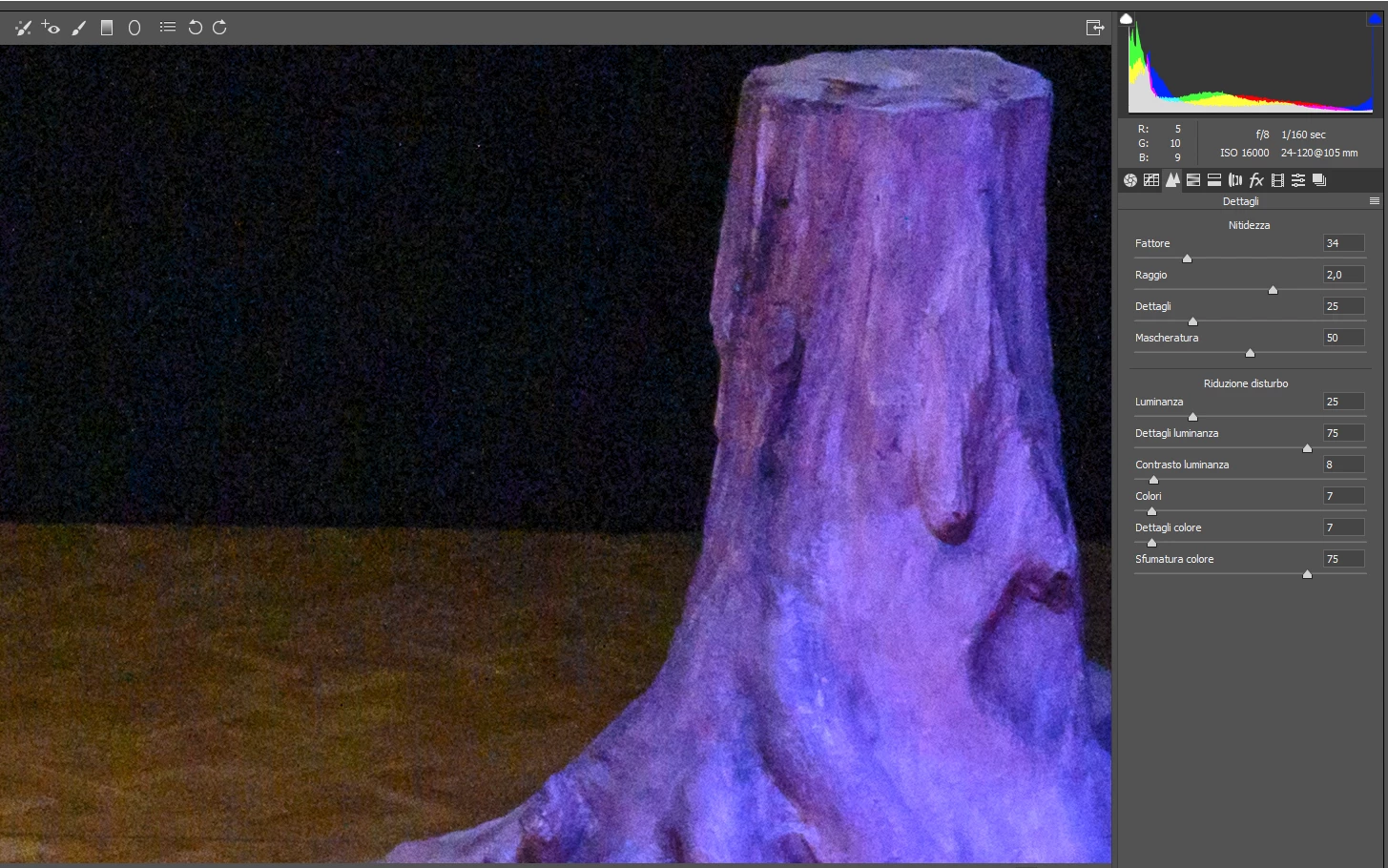

Hi all,
Camera RAW seems to not handle the best noise reduction with the files generated by the Nikon Z6 and FTZ.
Working with Capture NX-D the problem is solved.
Could you check and answer this question?
Regards

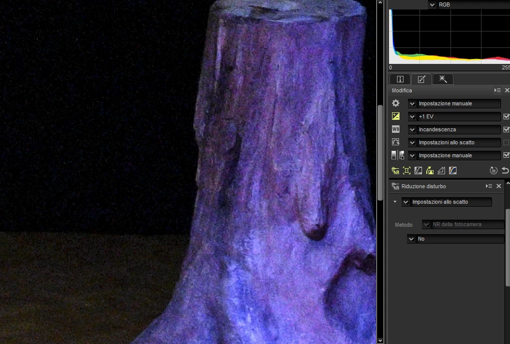

    andreag45773162
    April 6, 2019
    here the result with Nikon software:
    I Think and improvement should be done on Camera Raw for Nikon Z. At This moment I have the latest version of Camera RAW.
    Greetings Andrea

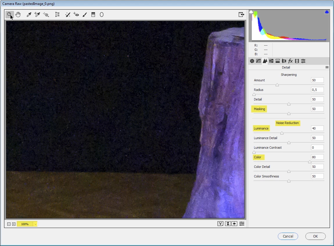

    Per Berntsen
    April 6, 2019
    You have to fix this manually in Camera Raw, it doesn't happen automatically.
    I opened your screenshot in the Camera Raw filter (which isn't quite the same thing as opening a raw file in Camera Raw, but similar), and was able to improve it a lot.
    Try these settings as a starting point, and pay particular attention to the Masking slider under Sharpening. It controls what parts of the image that will be sharpened - you don't want to sharpen noise in flat areas. Press the Alt (or Option) key while dragging the slider. White areas will be sharpened, black areas will be protected from sharpening. Always work at 100% view when applying sharpening and noise reduction.

    andreag45773162
    April 6, 2019
    Hi Per,
    nothing to do below the result.
    I need to use a different workflow, I don't konw if with Nikon Z7 there is the same behavior, the problem is present using higt ISO but in theater is easy to work in this condition of light.
    Thank you
    Regards Andrea
