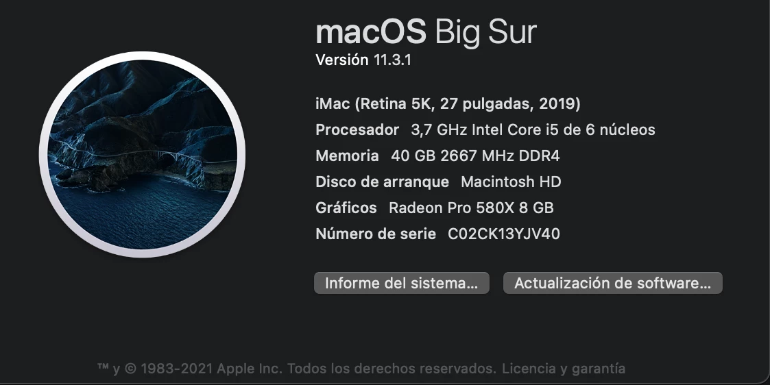

May 20, 2021 10:28 AM UTC
I have deleted the file TempDisableGPU2 and it works

I have the same problem. Before it worked, but not since the last update.
My computer supports metal
