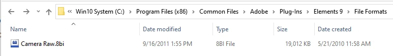

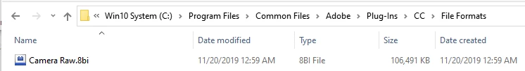

I found two Camera Raw.8bi files.  One is in the location below.
The parent-directories up to the “Plug-Ins” directory were all created on 12/31/2019 10:45pm when I installed CameraRaw version 12.1.  However these are Common Files so I suspect there are lots of other files having to do with the ACR 12.1 installation.
The other file location is seen below but in this case all the parent-directories have older dates suggesting it was not part of the CamerRaw 12.1 installation.  It probably came with my PSE 9:
I'm inclined to leave things as they are since everything seems to be working okay.  Sometime soon I'll likely migrate to PSE 2020 which will support the newer raw formats.  Hopefully the lingering ACR 12.1 installation won't cause any difficulties with that migration (its also said to be uncompatible with PSE 2020) and maybe before that someone who understands this stuff better than you and I will chime in with a suggestion.  I suppose I can trash some of these folders after uninstalling PSE 9 and before upgrading to PSE2020 but I'll probably leave them alone since I don't like fixing something that isn't broken.  Thanks for the help!
