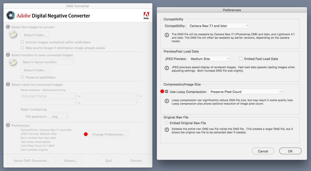

    You can use the dng converter and in the preferences select Use Lossy Compression

    Thanks.. I've tried that. What happens is the DNG's come up unreadable. When I have (in preferences) the "Use Lossy compression" turned off (i.e. "Don't use Lossy Compression), the NEF's convert to DNG's at the original size.. no problem. But when I try to apply "Use Lossy Compression" the DNG's cone up as DNG icons.. Bridge can't read them. Driving me nuts. Any ideas?

    Windows xp can use up to dng converter 8.3, so see if the 8.3 dng converter does any better.
