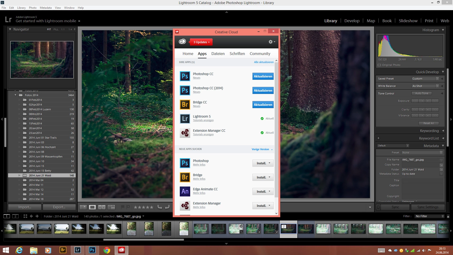

I expierience the same problems. Can't update to ACR 8.5. And the Creative Cloud Updater keeps updating Bridge CC, PS CC and PS 2014 CC...

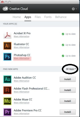

Follow the below mentioned steps to resolve the issue:
  • Quit and Relaunch CC app
        http://helpx.adobe.com/creative-cloud/kb/creative-cloud-connection-faq.html#id_10491
  • Open the Adobe Creative Cloud application.
    • Mac OS: Go to the Applications folder and open the Adobe Creative Cloud alias.
    • Windows 7: Go to Start > All Programs > Adobe Creative Cloud
    • Windows 8: Open the Adobe Creative Cloud application from the Start Screen.
  • Click the Apps tab in the Adobe Creative Cloud applications.
  • Click on All Apps, then Previous Version
  • Your installed CC Product would be listed, Click on Install Drop-down and then select the CC 2014 to install.
  • After Successful Installation, Update your Product
Let me know if you are still not able to Update ACR.

June 24, 2014
Thanks for your help... But PS CC 2014 is not listed under previous versions. My Apps  are all updated, but as you can see, ACR 8.5 is not.
After restarting my computer, all updates are gone... Seriously, I'm getting frustrated!
