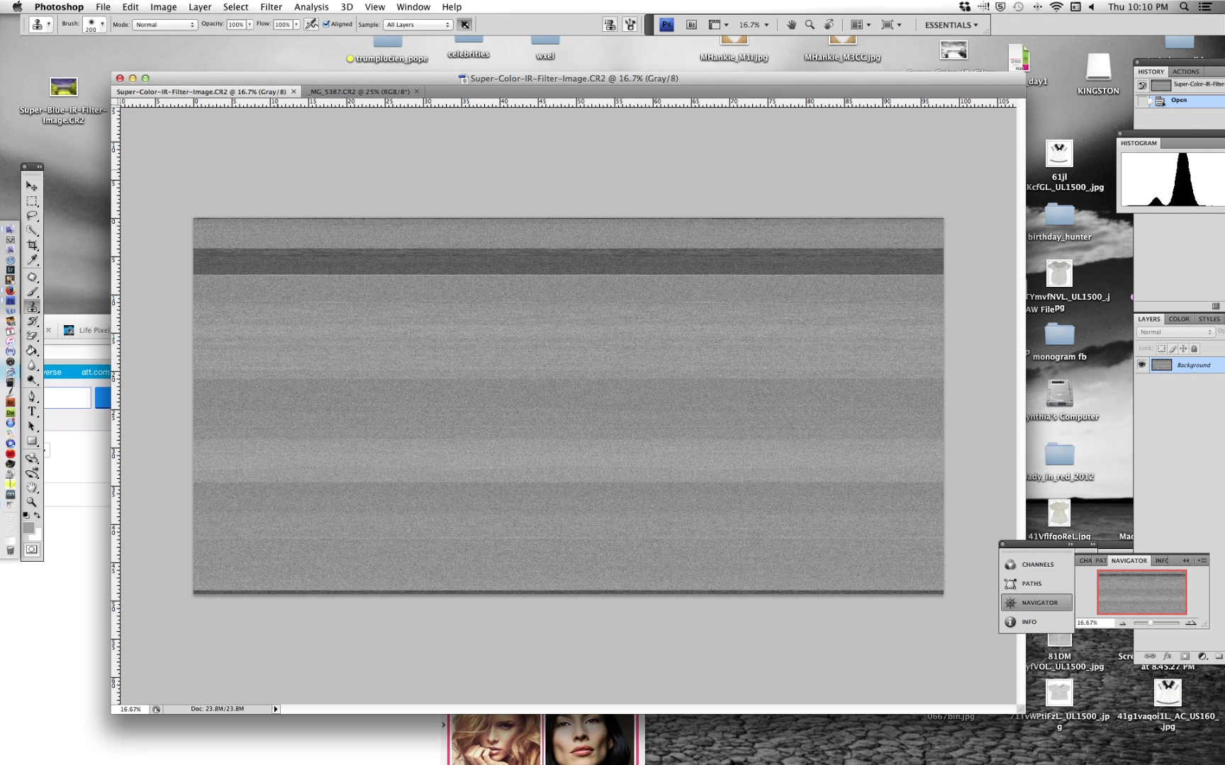

Jun 11, 2016 12:05 AM UTC
HI Chris,
I have a Mac, and Photoshop CS4.  I am converting a Canon d50 to an Infrared Camera.  When I download the sample photos from Lifepixel (CR2), they will not open in  Photoshop.  So, Daniel at Lifepixel walked me through downloading Digital Photo Professional.  The RAW photo shows there, but will not open in CS4 photoshop. I tried saving it to the desktop, and then opening it in Photoshop, but it will not open.  Can you help.  I purchased a camera and the process is $300 more, and I will need to be able to manipulate the c
Color channels.  I have no problem using RAW files from my 5d mark ii. Thanks. Cynthia
