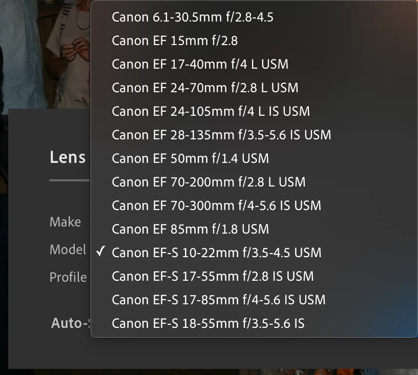

    The small set of Canon lens profiles in your screenshot means you're viewing a JPG.  Most lens profiles only work for RAW (.CRW or .CR2 for Canon) format files.  Select a .CR2 (instead of a JPG, PSD or TIF) and you should see many Canon profiles, more like this partial list that includes the profile you're looking for:

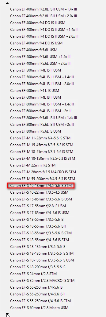

    I just looked here (Supported lenses  ) and I did find the
    Canon EF-S 10-18mm f/4.5-5.6 IS STMCanon5.6/8.6
    which shows that it needs LR 5.6 or ACR v. 8.6, Or, something that was released a long time ago.
    So, I'm not fully sure why your lens isn't coming up, it should.

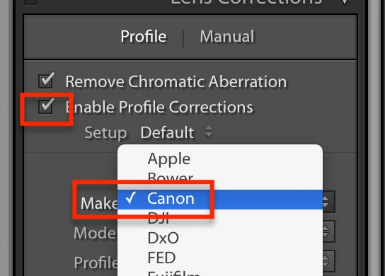

    I know for myself, sometimes when I go into Lens Corrections and select Enable Profile Corrections, it doesn't snap into my lens. However, if I select Canon from the "Make" dropdown, it fill in appropriately from there. I'm assuming you've done that?

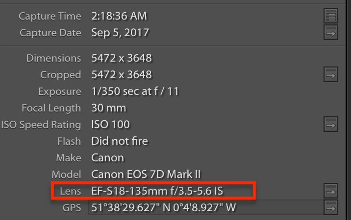

    And just out of curiosity, when you look at your metadata (from the Library tab, bottom right), what does it show for Lens information? Here's what mine is showing.
    I'm going to guess that if your metadata is not showing the lens, there may be a different issue going on here. But we'll see.

    My photo contains the lens info.

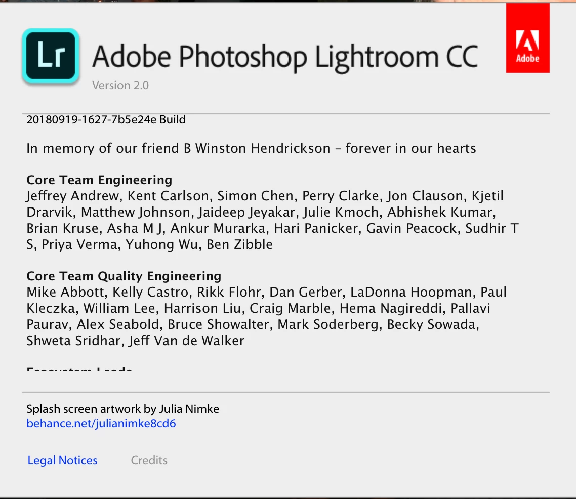

    I mentioned in my question that I have a trial version, this is the about screen.
    You mentioned other versions, this is what I got when choosing lightroom as trial version.
