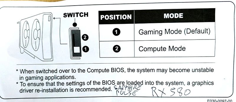

I don't think it's Mojave related - I had this with Sierra, High Sierra and then with Mojave. It was in an attempt to solve it that I upgraded so maybe I should be grateful.
I won't go through all the many hair-tearing tests and trials I tried but the TLDR is that it's a GPU problem and, if yours is an RX-580, there's a tiny switch inside (see attached pic) and that if it's set to 'Gaming' instead of the usual 'Computing' the crashes stop. Hope it works for you. Let us know?
