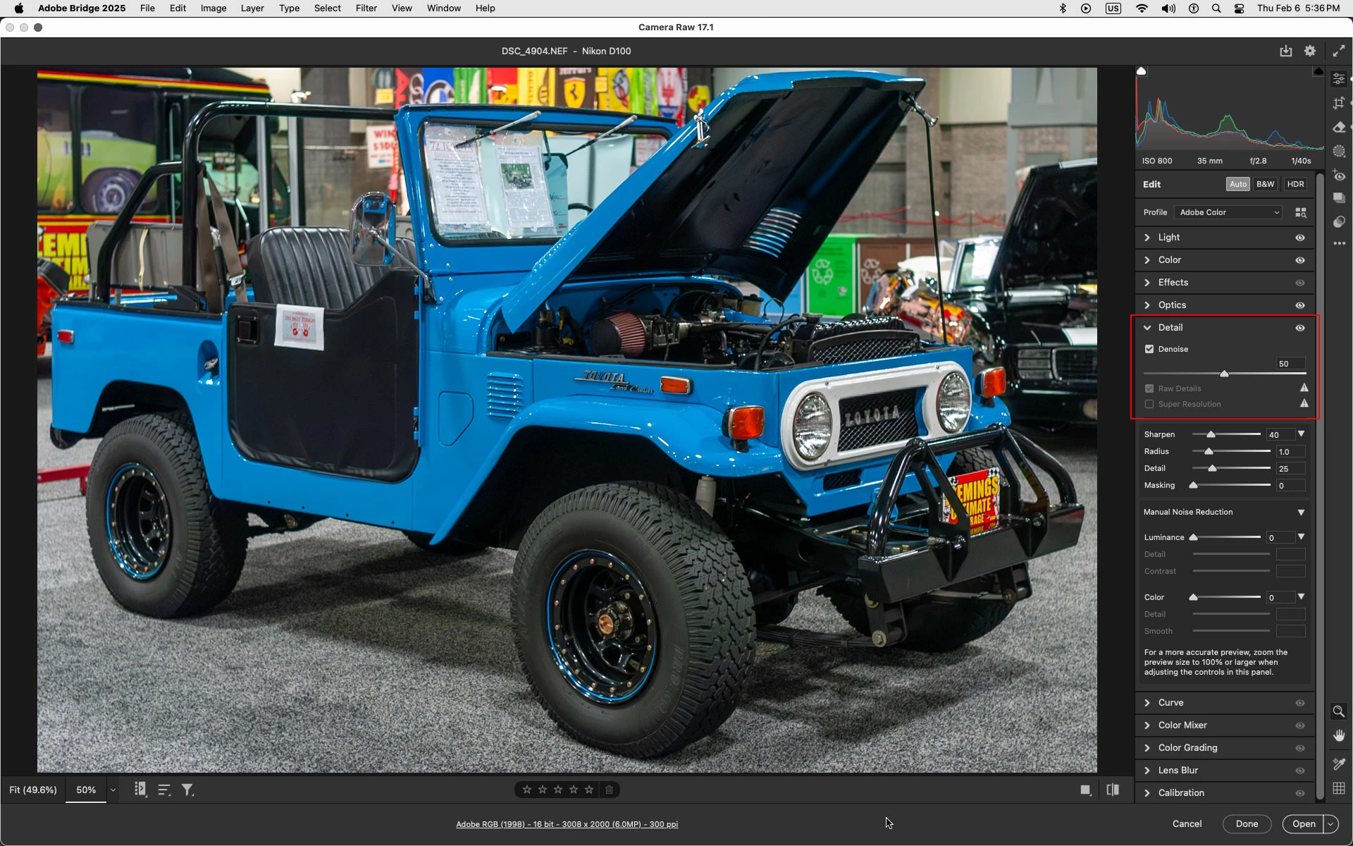

After you check New AI Features and Settings Panel in Technology Previews, the Enhance functions are moved to under the Detail tab, so the Enhance menu item is no longer there when right clicking on an image.
https://helpx.adobe.com/camera-raw/using/enhance.html

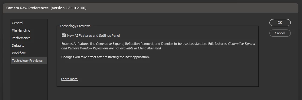

When you say, "I have enabled the Distraction Removal feature in ACR," are you referring to this setting in Camera Raw Preferences? -
Feb 5, 2025 1:11 AM UTC
Thank you Erik for your response.  Yes, that is what I mentioned as enabling Distraction Removal.  The image I am working on are Nikon NEF raw images from a D70.  I have tried again this morning, and whilt Distraction Removal is enacted and worked, a right click on the ACR raw image to engage Enhance, and Enhance is not visible.  I can still increase image size in ACR but it is probable that this differs from Enhance in the way it works.  I am just wondering that as the image files are now nearly 20 years old since shot, that their is something in the old files that prevents both features from working.  Will be interested in your thoughts.  Thanks again.
