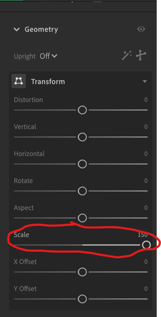

I figured it out! Im using Lightroom desktop
1. You want to go to your crop tool menu.
2. Find the geometry tab.
3. Use the scale slider.

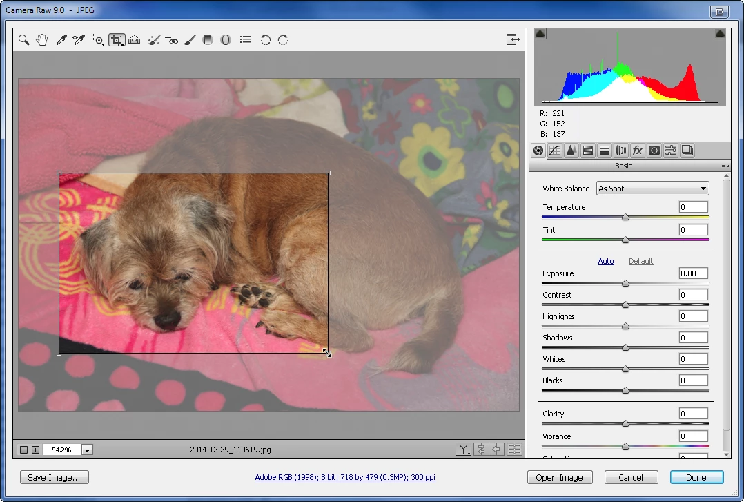

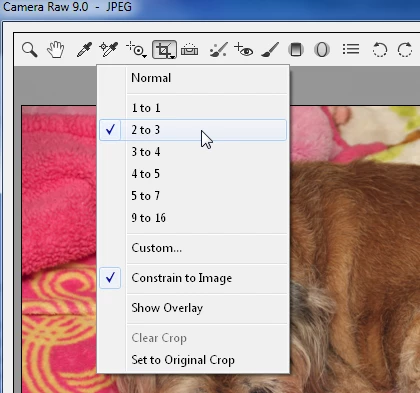

You want to "crop" the image...forget about using the term "zoom" in this context.
To accomplish this:
1)  left click on the crop tool
2)  right-click somewhere on the image and set your crop options, at least aspect ratio
3)  left-click and drag on the image starting where you want to top-left corner and ending where you want the bottom-right corner to be.  Then fine-tune the crop-box by click-dragging on the corner or side handles of the crop-box.
Here is what the crop-options look like, where I'm choosing a 2x3 ratio (same as 4x6):
Here is what it looks like after I've click-dragged out the area I want to keep and have hovered over the bottom-right corner to adjust it, slightly:
