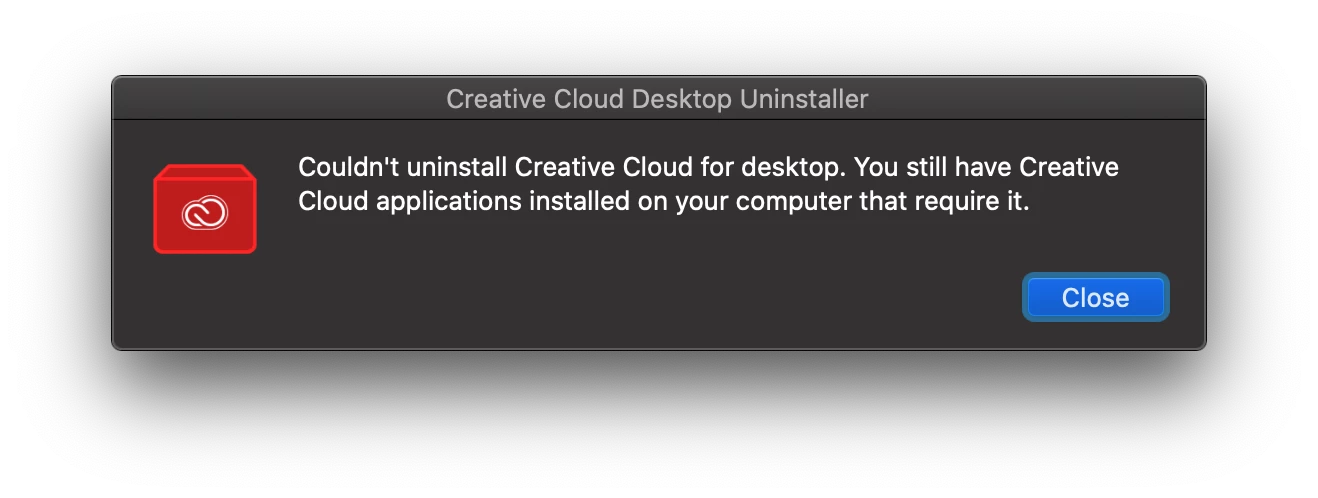

When I try to run the Creative Cloud Desktop Uninstaller I get the error message, "Couldn't uninstall Creative Cloud for desktop. You still have Creative Cloud applications installed on your computer that require it." I took a screenshot:

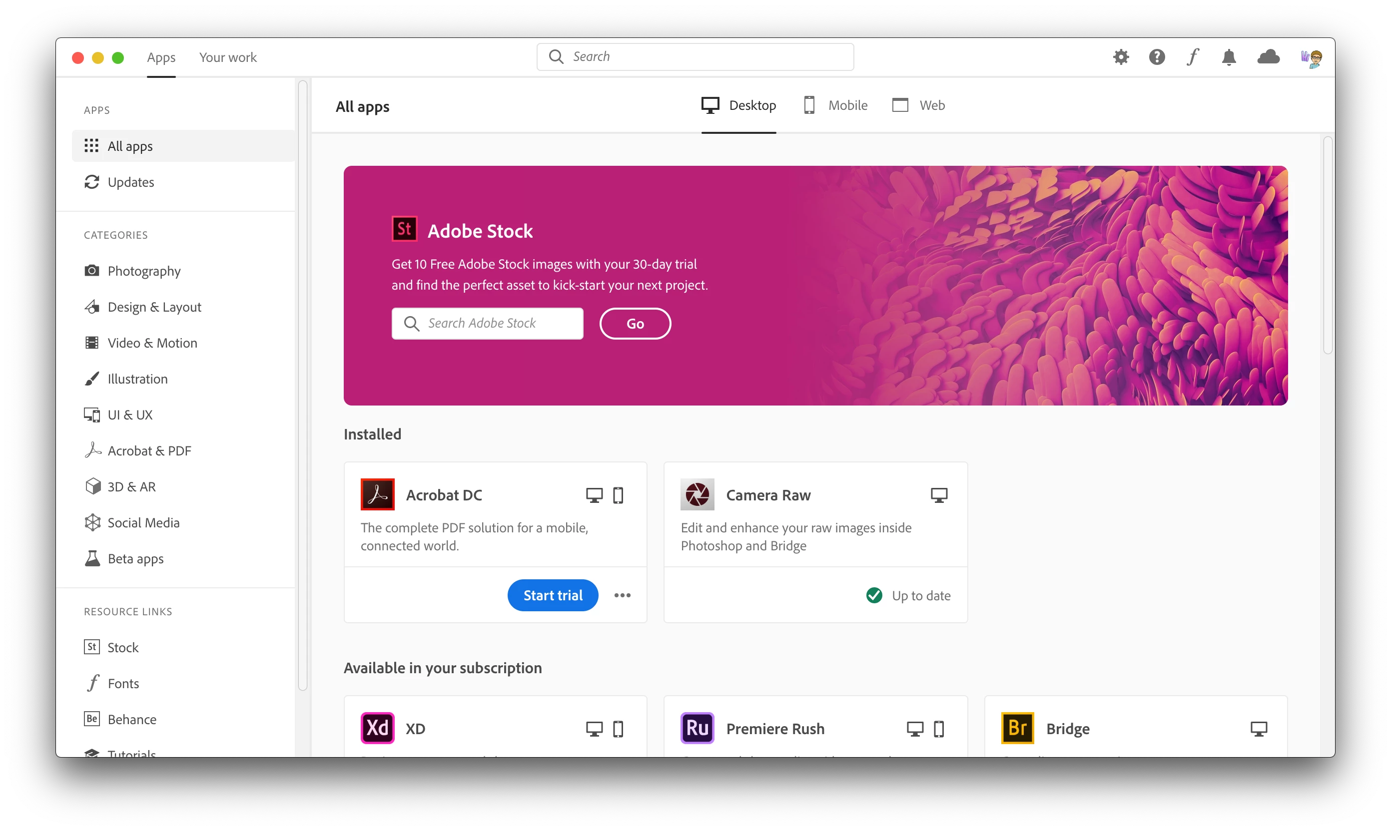

 This is particularly peculiar because 1) not a single Adobe-related application was running other than the uninstaller, and 2) I had already run the uninstallers for every Creative Cloud-associate application I had downloaded (namely Photoshop and Lightroom). Here is a screenshot that shows those two application no longer being recognized (as being on my mac) by Creative Cloud:
So what could this Creative Cloud uninstaller error message which prevents me from using the uninstaller talking about?! It is particularly frustrating that "Camera Raw" is being recognized by Adobe Creative Cloud as a standalone application yet it does not appear with an uninstaller in my applications folder; even worse: I cannot find an unstall option through Creative Cloud's interface FOR Camera Raw itself!
As you can see from the screenshot above, I did update "Camera Raw" to see if that would help me find the file and delete it--to no avail. I also updated Camera Raw so as to be sure of downloading the most recent installer per your previous tip--unfortunately running that installer NOT ONLY did not install and uninstaller, BUT ALSO did not register the previous--already and still extant--installation of Camera Raw and preceeded to USE AN ADDITIONAL 1.07 GB on my harddrive! So frustrating!

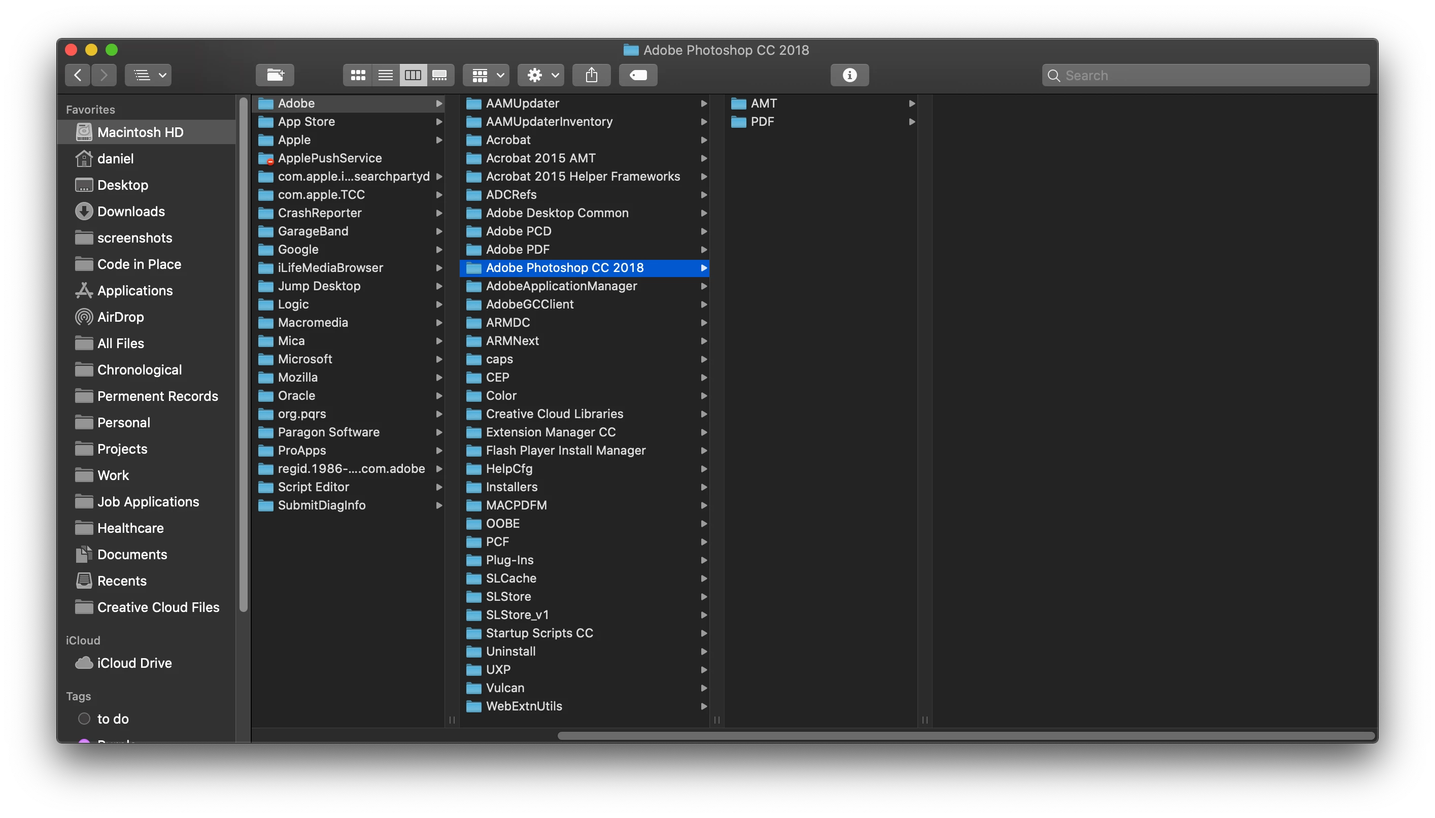

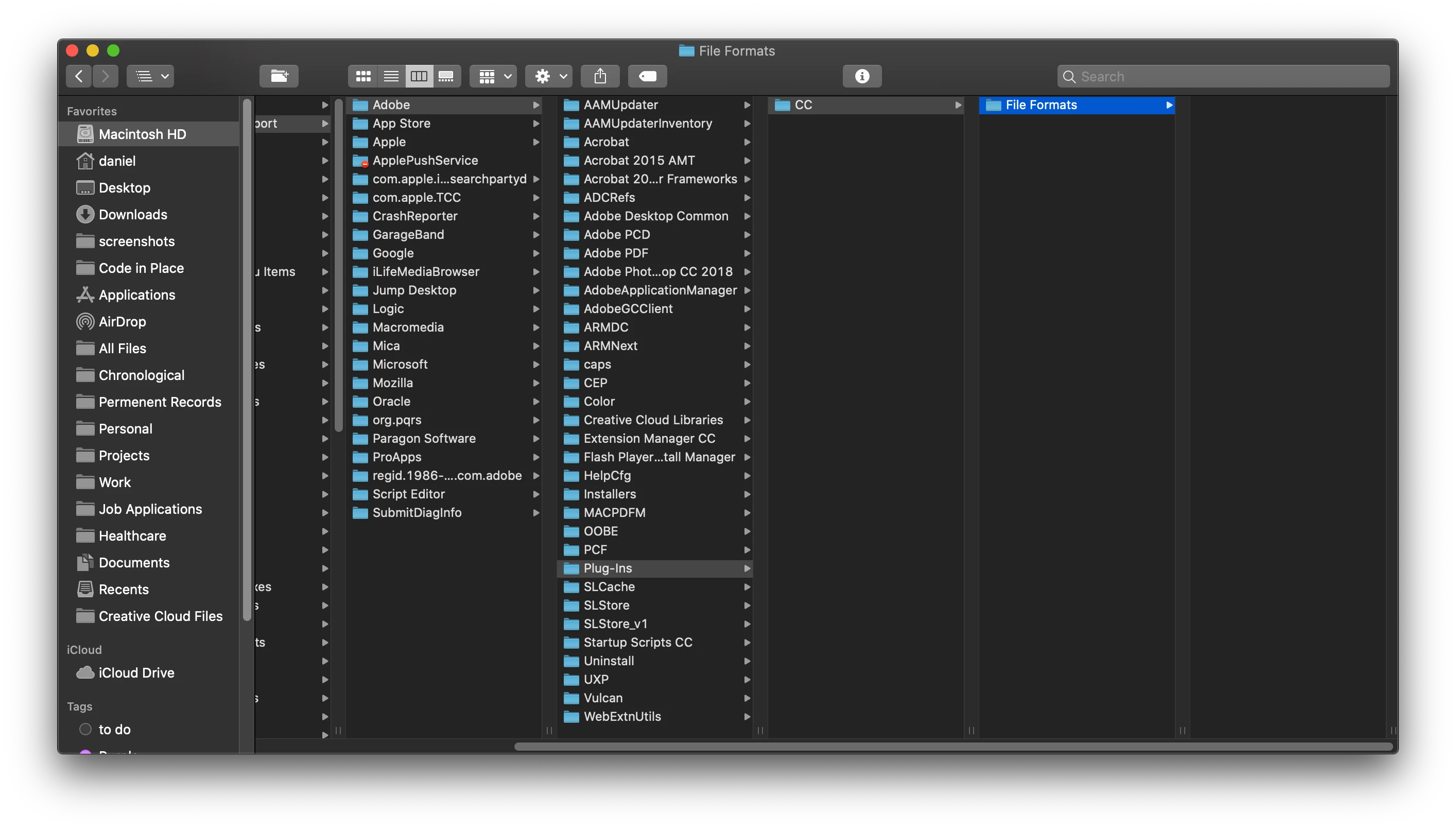

So, I tried @JimHess's method of finding the plug-in and other "Camera Raw" files. Please where I found those files and that I did delete them from my computer to the best of my ability:
 and
The location shown immediately above (not the plugin location) containd a "Camera Raw" files of significant size (between 400 and 500 Mbs). I moved both this file and the plugin to the trash AND 'immediately' deleted them.
I then tried running the Creative Cloud uninstaller and recieved the SAME ERROR message. When I open the Creative Cloud interface, "Camera Raw" still shows as INSTALLED...
Not only am I still unable to uninstall Creative Cloud, but also I have another, estimated 500 Mbs to 1.5 Gbs of my storage capacity being consumed by this... utter nonsense!
This is an unbelievable oversight by Adobe, and it needs to be addressed quickly. Please help!

Fortunately, when I revisted this thread, the "Related conversations" that popped up had a couple that caught my eye. The one that ended up being a big help was this one:
https://community.adobe.com/t5/camera-raw/cant-uninstall-camera-raw/td-p/10590807?page=1
The "Cant uninstall camera raw" with 5 replies (as of 05/28/2020) posted by joshuaf31716049 on Jul 19, 2019. Skip the comment marked as "Correct answer"––it is not for the situation I was in and go to Akash Sharma's response where he links to "Use the Creative Cloud Cleaner Tool to solve installation problems". I was able to use that to remove Camera Raw (and a older, hidden installation of Photoshop or some part thereof that the 'Cleaner Tool' was able to find)... whether it was one or both of these that prevented it before, it was certainly the case that I was ABLE TO UNINSTALL Adobe Creative Cloud... finally. Thank you to Akash (Adobe Employee,  Jul 22, 2019) for posting that link.
