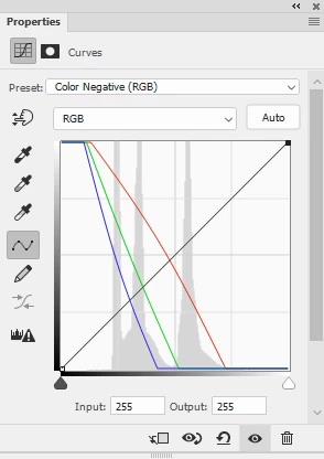

The best way to invert color negatives is by using a Curves adjustment layer in Photoshop.
The Color Negative (RGB) preset will invert the colors, and also compensate for the orange mask.
It does a reasonably good job most of the time, and you can tweak the colors by editing the individual channels, and adjust brightness and contrast with the RGB (black) curve.

Then invert the image using the Color Negative preset on an adjustment layer, making sure that there is no clipping in shadows or highlights. It doesn't matter if the image lacks contrast, but try to get the colors as good as you can.
