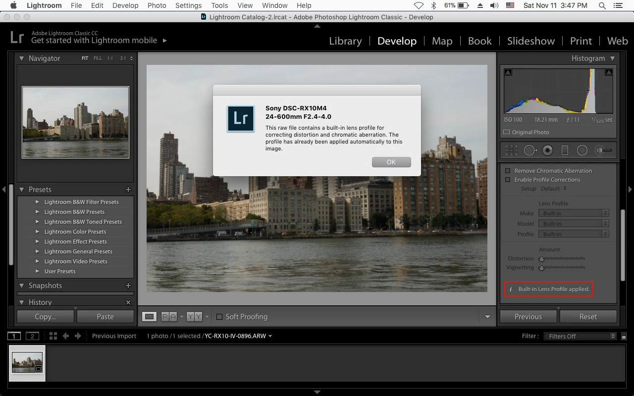

    Pretty sure those cameras use built-in lens profiles, which is why Lightroom doesn't apply it's own lens correction.
    If you look at the bottom of the Lens Correction panel you should see an little note and clicking on the little i tells more.
    Sample photo from here:
    http://www.imaging-resource.com/PRODS/sony-rx10-iv/sony-rx10-ivGALLERY.HTM
