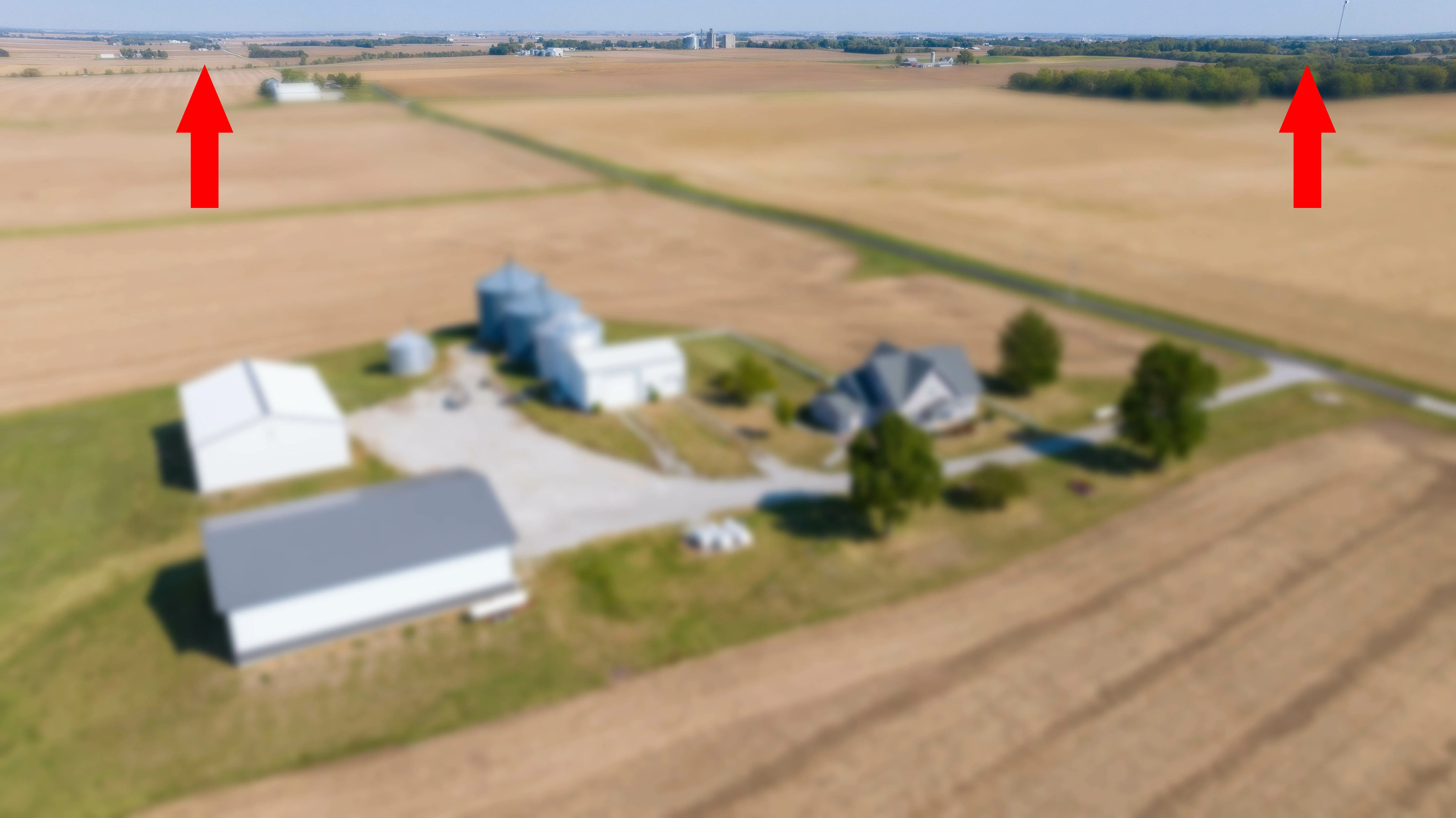

Mar 26, 2024 2:41 AM UTC
An example of how the horizon is distorted (low at the arrows, higher in the middle and higher outside the arrows). This horizon shouldn't have any distortion. It can't be corrected using Manual distortion in ACR.

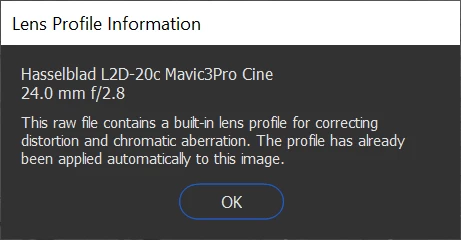

Mar 26, 2024 2:37 AM UTC
This is the embedded (aka "built-in") lens profile that causes the distortion. If there was a way to deactivate this profile in ACR, that would solve the problem.
